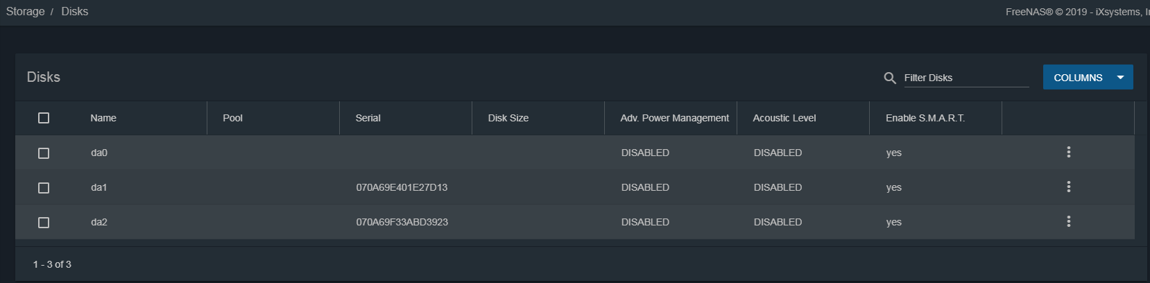

Hello, I am running FreeNAS-11.2-U5. I had it working fine with a Dell 1950 48 GB Ram on a SATA 12 slot storage array with Vmware. I have since decommissioned Vmware and rebuilt the Storage array with new and different drives. I have FreeNAS-11.2-U5 installed on 2 USB drives. I can see the drives on bootup only if I go into Ctrl R to configure the Raid on the Dell H800 Raid Card. Prior to decommissioning Vmware, I would see all the drives listed on bootup at the BIOS screen. I can create a RAID from the BIOS but unable to see drives from FreeNAS-11.2-U5 GUI. If I switch to the Shell and run camcontrol devlist I see the disks but when i go to storage/disks in the GUI I do not see them. I believe it has something to do with not being visable at the BIOS screen during bootup but i have searched high and far on many forums. I suspect it may be a setting somewhere in the bios but have not found it yet. Any help will be appreciated. Also if i create the RAID from Ctrl R I see the Raid from the GUI.

Just so I'm clear on the sequence of events and hardware here;
Was the PE1950 running VMware or FreeNAS before? Or was it running VMware with FreeNAS as a guest, and then it was converted to being a bare-metal FreeNAS machine?
If I recall correctly the PERC H800 and similar RAID cards won't pass unconfigured drives to the OS for access; this is why you only see them in the GUI if you use the RAID BIOS (Ctrl+R) to set up a virtual disk which is then presented to the OS.

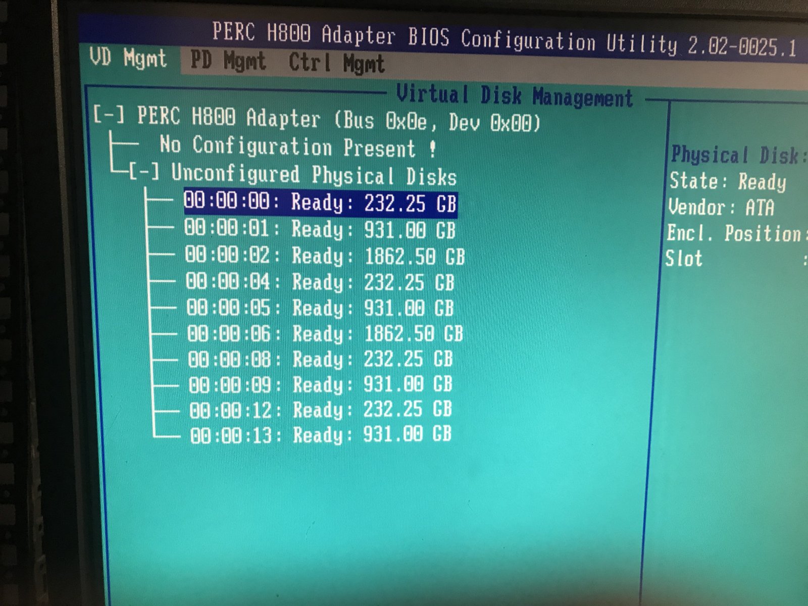

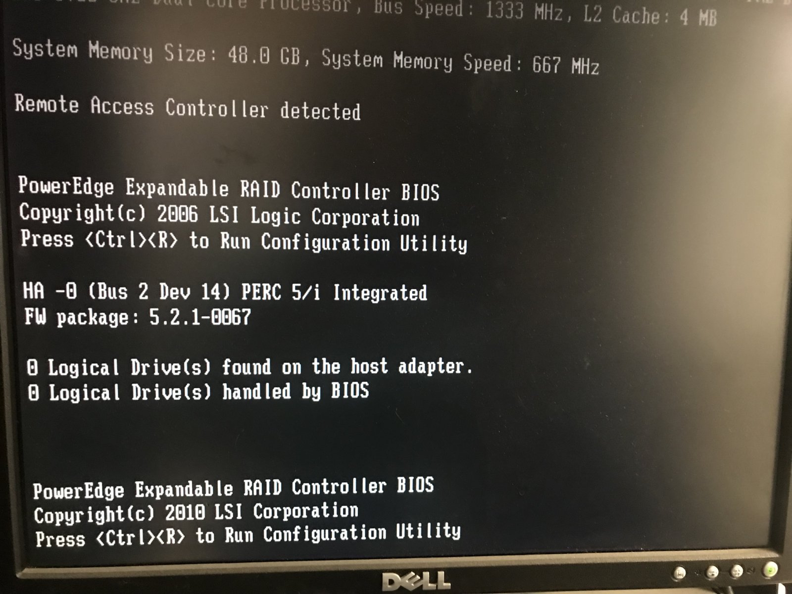

I will try that, this isnt prod yet so i can change things as neccessary to test. Attached are pictures of the boot process and RAID config. I will remove all but the 4 250's, i know they worked in the old config.
Thanks
Dave

In this case, if you want to use the H800 (which you shouldn't, in my opinion!) you would have to recreate the "logical disk" or "logical disks" in the PERC BIOS in order for them to be visible to the OS. It's showing "0 logical drives" because none are configured, and without that, the PERC won't pass the unbound drives for data access to the OS. You'll see the passN devices because the SAS bus is aware of their presence for things like hot add/remove/etc, but there's no actual access allowed.
Simply put, the H800 is not the right hardware for this use case. Get an external SAS HBA like the H200e (and flash to IT mode) or the "6Gbps external SAS HBA" - not sure what the Dell P/N is for that model.
