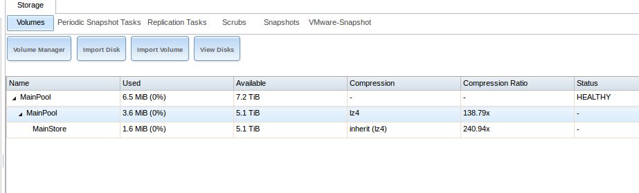

I have just setup FreeNAS on a system with 4 x 2TB disks and I want to use RAIDZ1 and iSCSI. Reason for RAIDZ1 is that I want a bit more disk space than what you will get with a RAID10 volume.
I followed the wizard and at some point it asks me for the space of the iSCSI volume. When setting up the volume it estimated the size at 5.5TB. I want to use the maximum available space for the volume if however I specify 5.5TB and look at the Storage it seems that the Maximum size is 5.1TB. (Please see attached image)
I ran the wizard a few times and found that I can, for instance, specify the size for iSCSI at 7TB ... but what will happen with such a config ?
Further if I do it manually it indicates that I cannot create the volume bigger than 80% of the available space. In other words 4 TB on my RaidZ1 setup.
So what would be the correct configuration for maximum disk space with my current setup?

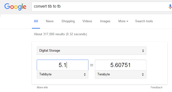

There is a difference between TiB and TB. Also, Bidule0hm has a great sizing calculator.
Finally, performance on iSCSI really starts to suffer beyond ~50% full, and out past 80-90% it's probably really bad. Jgreco has a couple graphs that depict it.
You might want to reconsider your approach. Either avoid iSCSI, add storage, or plan on a lot of waiting.

Ok ... And lets say that I still wish to use iSCSI ...must I specify the disk space as 5.1TiB ? In the wizard you can just us T Is this TB or TiB ?
