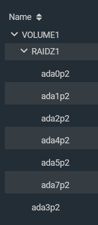

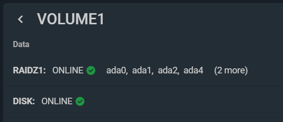

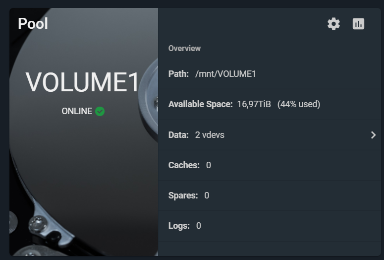

Ciao a tutti, ho creato un nas freenas 11.3-u5 con 7 dischi in raid z1, la cosa strana e che uno di questi sembra proprio esterno al raid e se lo disconnetto tutto il raid va offline... in pratica mi vede due vdev, uno con 6 dischi raidz1 e uno con solo questo disco che non posso disconnettere senza mandare offline tutto il raid. io voglio solo un raid z1.
Qualcuno riesce a spiegarmi come fare?

You would appear to have added a second vdev by mistake. Your only solution here is to backup your data, trash the pool and start again.
Did you try to expand the pool by adding an extra disk?
I suggest you make a backup quickly as your pool is at risk (as you have noticed) that one disk has no resiliancy and also has no way of correcting any issues. Lose that one disk and you lose the pool.

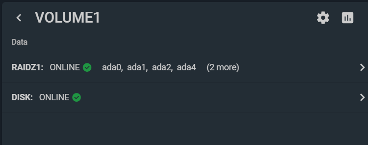

I'd like to confirm things by seeing the output of zpool status please - run from the shell

here...

It seems you have added the disk as a single disk vdev to the pool. You cannot revert out of this.
As far as I am aware the only option is to trash the pool and start again. You will need to copy all your data to somewhere safe first of course. You seem to have used slightly less than 8TB so it might fit on an 8TB drive (maybe) - but 10TB would be safer.
Actually - I think you could add another disk to the single vdev to make it a mirror which would get you some resiliency - but it won't fix the mess and you will always have 2 vdevs with one mirror and one Z1 which is doable - just not terribly recommended. This is assuming you have the capability of adding a new disk (Sata Ports etc). This might buy you time to get a bigger disk, copy the data to the bigger disk and then redo the pool. (during which time you data will likely be at risk on a single disk). All depends on what hardware you have available to use and its resources
