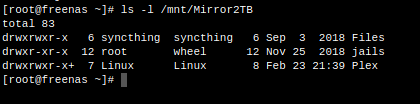

Can you show the result from ls -l /mnt/Mirror2TB ?
Sebastianws
Feb 23, 2020
17
Right ok, that makes sense. That was a good way of putting it!
This was the output from: ls -l /mnt/Mirror2TB
9,700

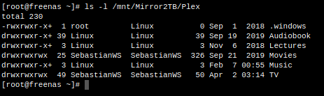

OK, how about ls -l /mnt/Mirror2TB/Plex ?
Sebastianws
Feb 23, 2020
17
Yeah the file does not appear there as well. 'kids' was definitely within that same group of folders and I have checked within all of those folders as well to ensure that I didnt acedentaly move it. But I could not find it.

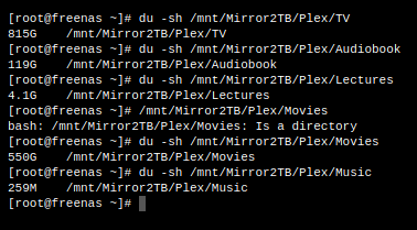

So if I get it, you are saying you had (before the problem) 1.6 TB of files under Plex?
Now you see that you still have it...
So the job would be to dig (using that same command) into each of the subdirectories of Plex (like du -sh /mnt/Mirror2TB/Plex/TV ) and see where the space has gone... if you can get to 1.6TB by adding them all up, it's still there somewhere.
Also, if you know the name of one of the files that would be amongst the missing, you could try find /mnt/Mirror2TB/Plex -name "*guess*" (where you replace the word "guess" between the asterisks with the word you know).
Sebastianws
Feb 23, 2020
17
Yeah easy,
So when search for the sposific file it, which I know is there, it returns as if it has successfully completed a command but does not provide information:
In regards to the storage:
This equates a total of 938.35G
there was an additional 177G that i have since removed from the server
Total of: 1,115.35GB / 69.7%
out of: 1,600GB
so just over 30% of the data is uncounted for.

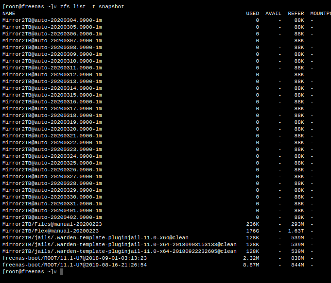

Are you convinced there are no snapshots?
How about running
zfs list -t snapshot
Sebastianws
Feb 23, 2020
17
Oh damn there are, I was sure I didnt have it set
the: freenas-boot/ROOT/11.1-U7@2019-08-16-21:26:54 might be perfectly timed as well.
How should I proceed from here? Just try and role back to that and see if the missing folder appears?
9,700
start with
zfs set snapdir=visible Mirror2TB/Plex
Then look under /mnt/Mirror2TB/Plex/.zfs/
Rather than rolling back the snapshot (and losing changes you made after the problem), just copy the files out of there back to the original/desired location.

You could start with cd /mnt/Mirror2TB/Plex/.zfs/snapshot
and
ls -l to look at what's there. The commands we were using before will also work.
Then use something like this (maybe need some changes based on what you find with ls and cd:
cp -R /mnt/Mirror2TB/Plex/.zfs/snapshot/manual-20200223/Kids /mnt/Mirror2TBPlex/Kids
Sebastianws
Feb 23, 2020
17
I successfully navigated there and found the 17 snapshots.
could you explain where you got the "manual-20200223" from in the restore command (cp -R /mnt/Mirror2TB/Plex/.zfs/snapshot/manual-20200223/Kids /mnt/Mirror2TBPlex/Kids)? And is that part of the command how to select the snapshot that you want to restore the "Kids"file from?
Im just not sure how to point that restre towards the correct snapshot.
9,700
In your screenshot, the line with Plex in it, after the @ symbol (the name of the snapshot).
The snapshots are mounted and visible under /mnt/Mirror2TB/Plex/.zfs/snapshot/
What you do with those files (except I don't think you can delete or change them) is up to you. So in this case, copying them to the wanted location is the right action... later when you delete the snapshot, your copy will remain.
In case it helps, it looks like you only have 1 snapshot of that dataset (the one that is holding 1.6TB).
