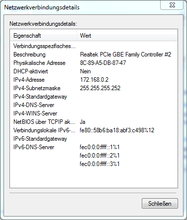

i did it like this:
1. pressed in the freenas server menu the "1", didn't reset the network config and configured ipv4
2. as an ip i set: 172.168.0.3 , as netmask: 255.255.255.252
Same in windows, i attached the config:
Edit: even ping doesnt work

Use 192.168.0.? Not 172. Then use ping to verify the connection.
Netmask should be 255.255.255.0 since 192 is the range for a private class c network.

I used 172. because my computer is already in a network with 192.xx.xxx.xxx .......
EDIT: 192.168.0.1 works if i disconnect my other network........
EDIT2: Everything works :DDDD I just used 192.172.0.1 and 192.172.0.2 .... i dont understand Classful network but yeah it doesnt matter;)
Thanks a lot!
