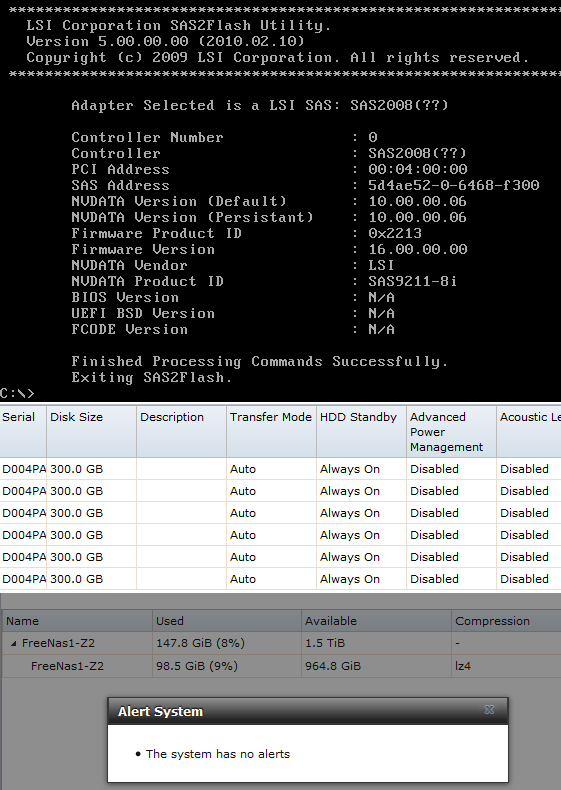

Wanted to followup on this thread with my results. First a big THANK YOU to jgreco, that link was invaluable. I'd seen it earlier, but didn't get much into it favoring one that looked 'easier' (with the typos). Plus the download link on that page was most useful not just to create a FreeDOS disk, but all the tools put at the root level so not having to fight with shortname directories. Anyways, I'm happy to report complete success! :)
Dell's platform, at least the R610, seem to really fight you all the way with 'non-dell' hardware. Initially megerec didn't work and sas2flash saw no drives after my inadvertent flash of the card. The trick as alluded to others, was to use a different system. I happened to have a yet to be e-wasted desktop. Megarec worked and allowed me to reset the drive back to a usable state. But then sas2flash on that system gave the 'Pal initialization' error. But once the H200 was reset, putting it back in the Dell sas2flash now recognized the card. So I was able to flash to the 6GBPSAS.FW firmware and then give it a new SAS address, which I didn't have, but thanks to a screenshot of someone else's success I used that address. (Side note: why do a few 'how-tos' blank out the SAS address??? It's not like there is any chance in hell that we'll ever meet and I end up buying his card and putting it into the same machine.. lol.. ) Anyways, a reboot and now the H200 reported as the JBOD version. Next was to flash to the p16 firmware. I messed this up initially thanks to DOS shortnames and flashed to P17 instead. Oops, sas2flsh didn't allow me to go backwards. So pulled the board out and back in the desktop and used megarec to start all over. It all worked great and running iozone/dds continuously now for a few days and randomly pulling out drives (H700 crashed Freenas on an active system doing this) or cutting power and I'm quite happy with FreeNas recovery and robustness so far.
