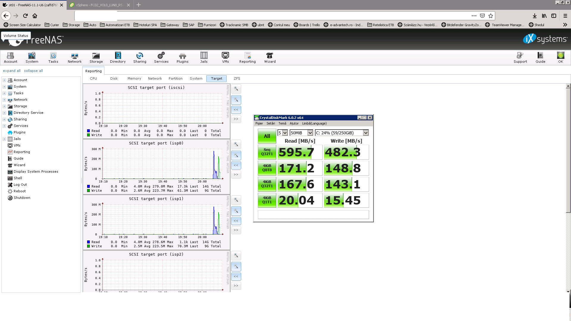

Holt Andrei Tiberiu
Jan 13, 2016
129
What kind of drives? How have you measured the performance? This is on FreeNAS?
Freenas 11.1u6
24 SATA 2.5 inch Disk's, Seagate and WD mixed.- it started with 10 Seagate and grew over time, 1 pool.
SAS9207-8i controller connected with 2 x sff 8087 to the HP SAS BACKPLANE.
Server HP ProLiant SE326M1, 25 bay SFF Model
4850 iops read and 3770 write @ 4k random
128 GB Ram.
This Storage is serving 25 production vm's.
3 are MySQL databases in UBUNTU
6 are MSSQL Databases
The other are from Domain Controller's to other type of VM's, including a apache 2 server housing more than 20 websites.
I did a screenshot.
Connection is by 2 x 4 gigabit FC connection to a EMC 4100 SW. Each host is connected by 2 x 4 GB/s FC to the SW.
Round Robin is used in VmWARE to the datastore.
Host's are Vmware 6.0u3 and 6.7 versions.
When i added a SSD ( Samsung Evo 860 i did not see any raise in real life performance )
Aaa, and it is in production for over 3 years.
