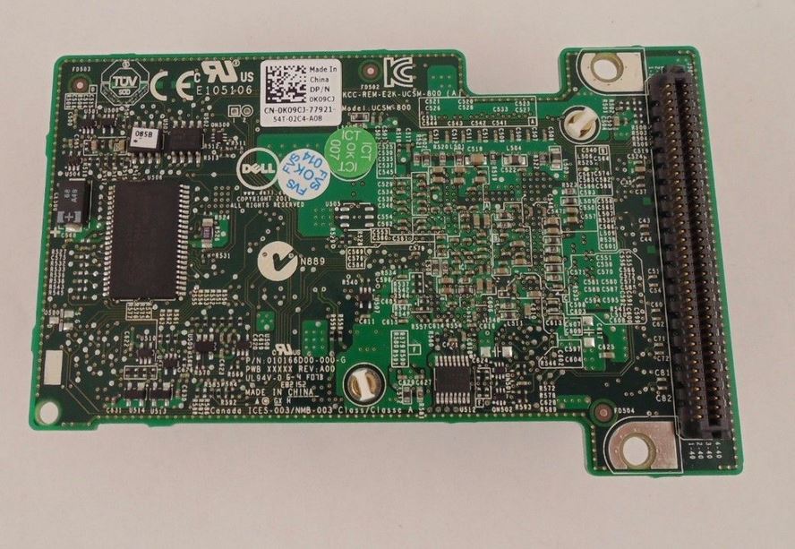

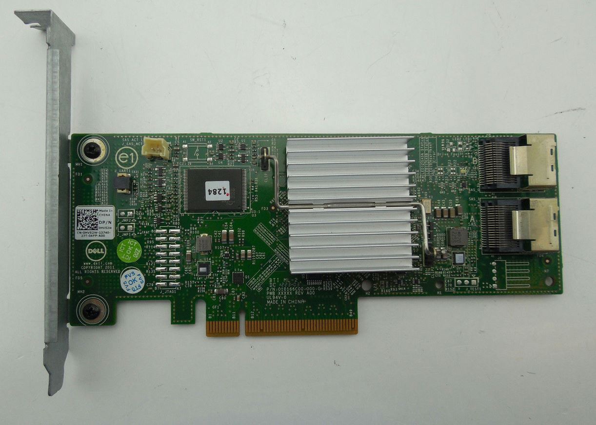

I have attempted to attach images below for reference and clarity.
The Dell H310 'mini' card fits in a special slot that is only good for that card and the card is not able to work in that slot once the cards firmware has been changed to the IT mode firmware that is needed for FreeNAS. The H310 mini is useless.
The good news, from a certain perspective, is that there is another slot in the chassis that you can put a 'normal' Dell H310 card into and the normal card can be flashed to IT mode and work properly with FreeNAS. I use them in all of my servers. The bad news is that it is a 1U server and I hope you were not planning to use that slot for something else. This is the reason I don't like 1U servers, very limited expansion possibilities.

H310 mini card.JPG Dell H310 mini card
H310 mini bottom.JPG Dell H310 mini bottom
H310 card.JPG Normal Dell H310 card
