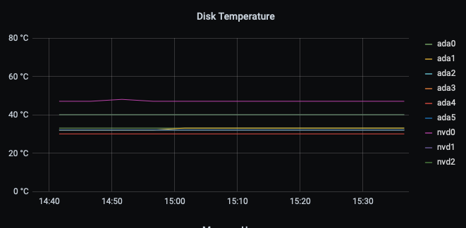

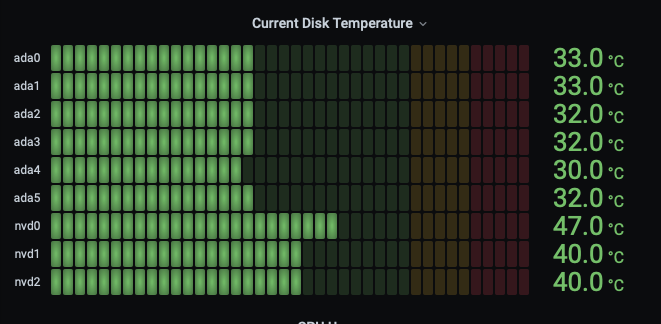

I can recommend running Grafana for that:

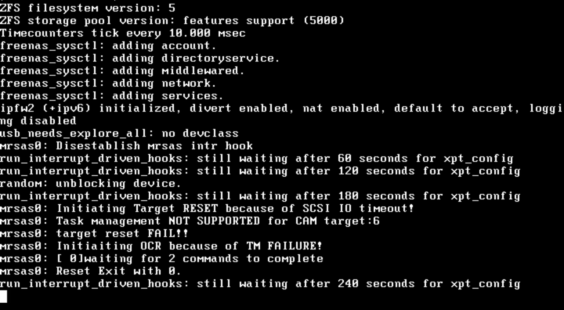

As an update I was able to boot on ESXI from USB, the NVME M2 Samsung 970 PRO is available there and installed FREENAS. I set H730 mini to passthrough. Card is in HBA mode.
The problem that I am experiencing is that it's not booting when I give it the add pcie device and the H730 mini.
FREENAS is booting if:
- give the VM 1 vcpu (boots with H730 mini designated to it)
- VM 6 vcpu no H730 mini designated to it
Notes:
- FREENAS works on barebone installation on this machine with no problem (tested)
- I also did the following to ensure the mrsas driver is being used
To ensure the mrsas driver is being used edit /boot/device.hints, add the following line and reboot
hw.mfi.mrsas_enable="1"
attaching a print screen on the boot issue
You guys been amazing, thank you again for all the help.

Sorry, I somehow missed that ESXi part. FreeNAS/TrueNAS has got collectd builtin, so you can send all your health data to e.g. InfluxDB and run Grafana on that. It's trivial to setup in a FreeNAS jail. I don't know how/if ESXi can send data, but a quick search looks promising. Telegraf seems to be the tool of choice to pull data from ESXi and send it to InfluxDB.
I can surely help with the Influx and Grafana part.
