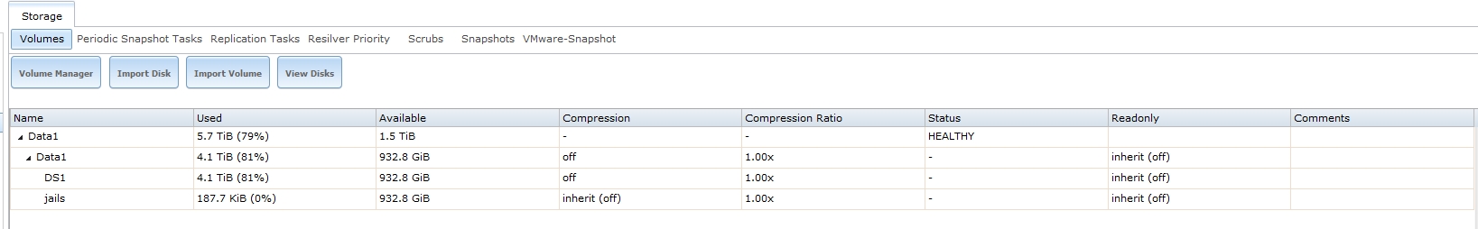

I have a jail folder in my zpool that I'd like to remove and I'm at a bit of a loss on how to do it. In searching through the forums over the past few days I see some similar posts, but I'm not really getting anywhere on solving my problems. The forum search results did give me some good hints on what to bring to the table to help solve this so here it goes.

I just use FreeNAS for storage. I don't (and never have) installed any plugins. CIFS and NFS shares only. No VMs. No idea where the jail came from. It's using about 1TB of my zpool.

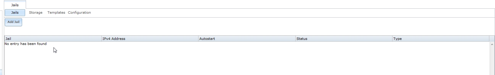

warden list shows this (nothing)
ID AUTOSTART STATUS TYPE​
In the WebUI nothing is listed under jails
In the WebUI a jail is listed under Volumes

Thats not a unwanted jail. Its just an empty jails folder. It will be created wherever where you set the jails directory.

Could you suggest how the folder might be removed and the jails folder's storage space might be returned to my DS1 storage space?
I doubt you'll miss that 187.7KiB.
