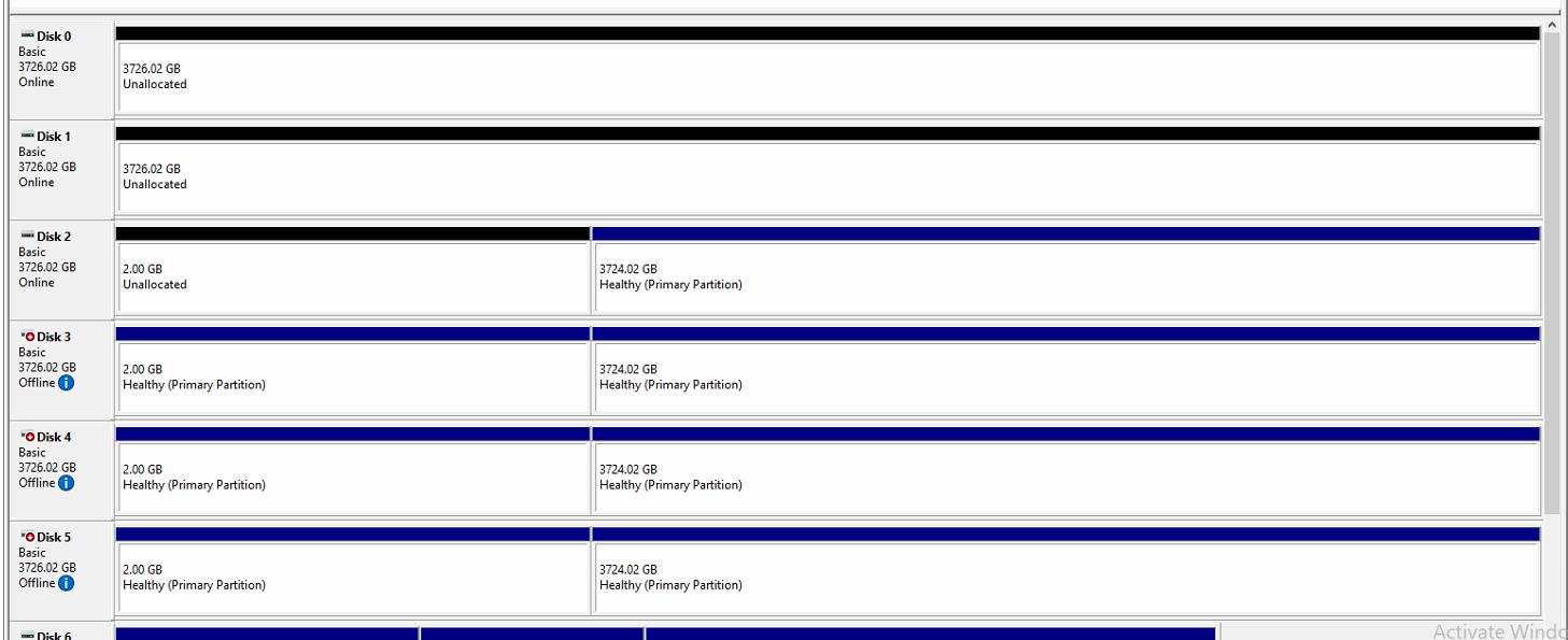

During the windows 10 install I mistakenly thought the m.2 was in multiple partitions for some reason. I just did not take the time too look closely and delete 3 partitions on 3 of the 6 drives. Each drive has 2 partitions. 1 2gb and 1 3.64tb with the balance of the storage.
I think if I could recover the partition on at least one drive i could rebuild the data as the with three drives are intact. I am trying to recover the partition with Easeus partition manager but it is taking forever and I'm just not confident it is able to read the data due to zfs formatting.

As long as you deleted the 2G partitions, you should be good, These ones are for swap. The data is on the biggest one. So you said you deleted 3 partitions. If by any chance at least one of them is a 2G, you should have the required 4 data partitions to recover.
So did you indeed deleted only 3 partitions (and not 3 drives) and by any chance, did you delete at least one 2G partition?

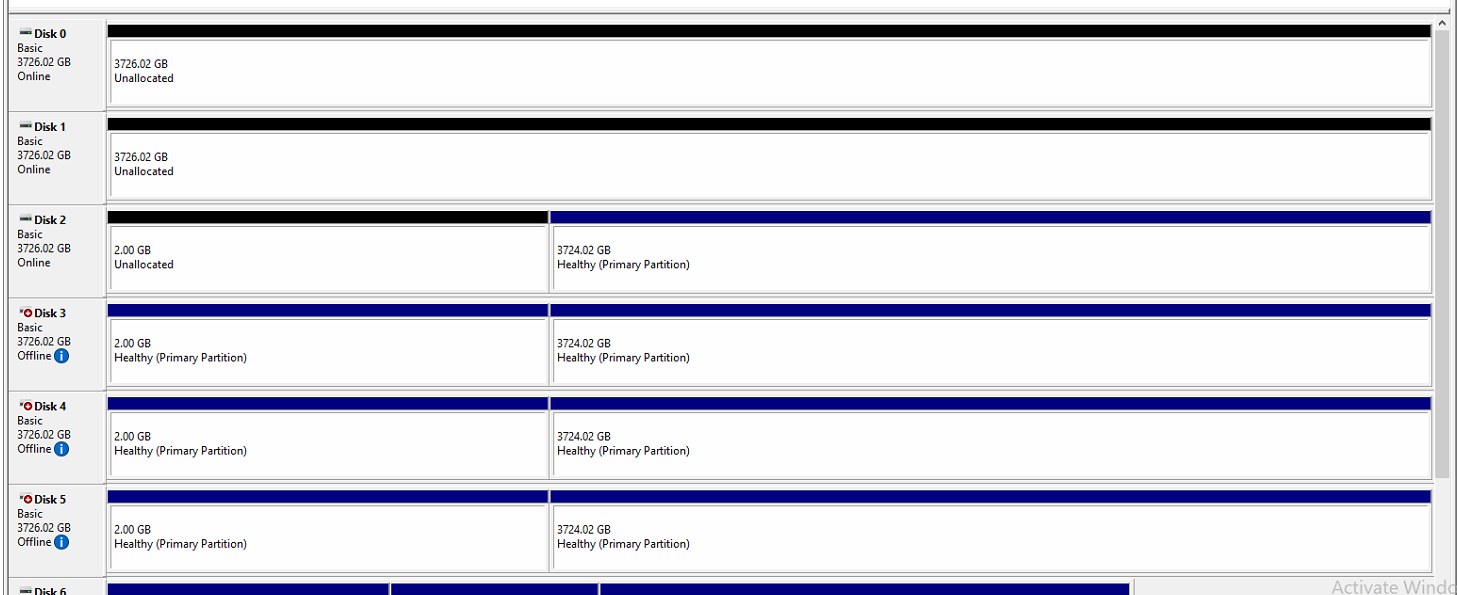

Ok, so with 4 data partitions, you would have been good if you did not aggravated the case. On which drives did you used your Easus recovery tool ? I hope it is only on the ones without any data partitions... If so, good and do not try to recover anything with anything else then FreeNAS itself.
Second No-Go you did was to try a recovery from a virtualized FreeNAS. FreeNAS must have direct access to the drives. By putting an hypervisor between it and the drives, again you may well have damaged the drives.
So first thing is to make yourself a new FreeNAS bootable USB stick. Do it without touching your data drives anymore. Unplug them until you are ready to do the complete recovery. Also, you did not mentioned your pool was Raid-Z2 but I guessed it was because the way you wrote your post. Next thing will be to confirmed the layout you used for that pool.

Good Morning Sorry for the delay my wife had surgery yesterday and this is the first chance I have had to reply.
  • I have only used the recovery on disk 0 in the screen shot is has no partitions now.
  • Drive configuration I don’t recall the exact configuration, but I am pretty sure it is Raid z2. Is there a way I can confirm this?
  • I have the drives all disconnected new usb with free nas up and booted.
  • Data drives are all still disconnected.
Awaiting your kind instructions and help. Thank you
