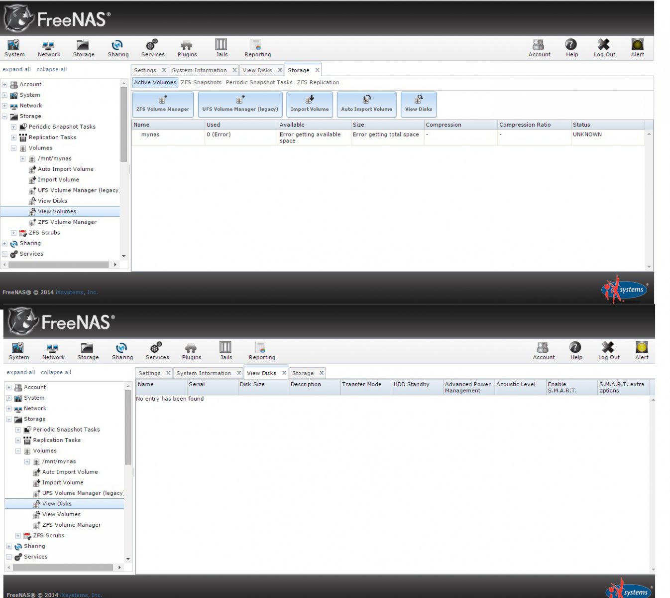

I have a problem: I woke up one day and looks like all my data was gone. I have FreeNAS-9.2.1.7-RELEASE-x64
and I get a "error getting available space" when I look under volumes, and I get no disks when I check under disks. While booting tough the bios detects both 3TB seagate drives, and I can't believe they both failed. I have them in mirror mode, can't remember which raid is that. I have my life on these disks and I have no clue how to rebuild the file system, if that is the problem. Can't use windows recovery data tools either.
Any idea what is wrong and what should I do? Keep in mind I'm linux retarded unfortunately, even though I'm an engineer. I adventured on unfamiliar territories because I hate windows, even though I use it every day, and was looking for a geekier NAS OS other than windows server. Any help is greatly appreciated

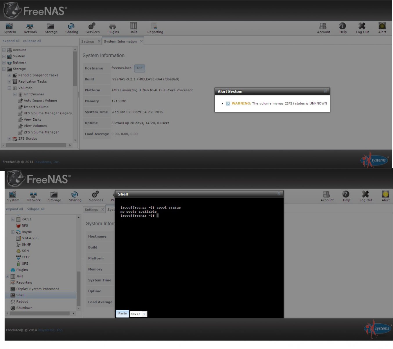

Go to the command line (either using the shell button in the web GUI, or ssh to your server) and run 'zpool status'. Post the results here, along with your system specs. Your screen shot shows a warning (the alert light is flashing yellow)--what does it say?
Zpool returns "no pools available". Alert light says " "the volume xyz (ZFS) status unknown" . Thanks

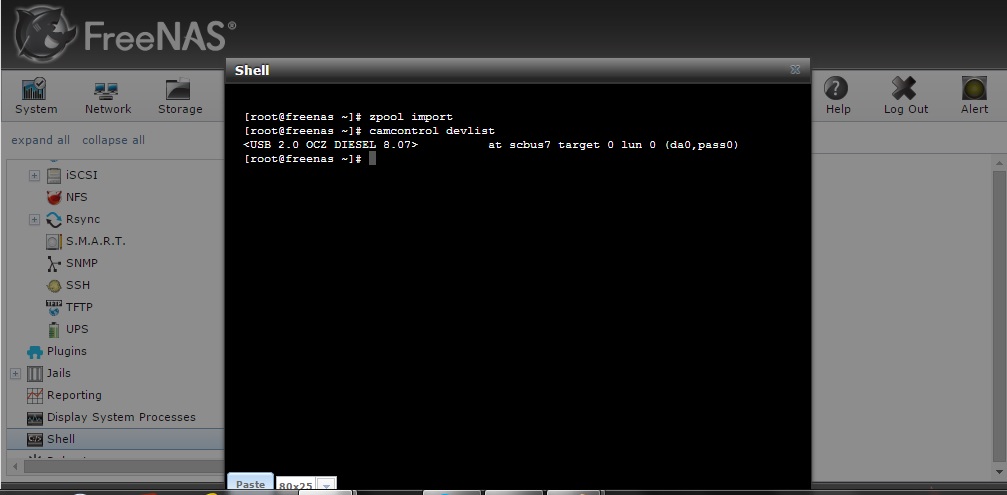

What does 'zpool import' return? How about 'camcontrol devlist'?
They return respectively nothing and the USB I have the OS on.
Any idea of what could happen? I read around while trying to find an explanation that freenas doesn't like hard reset, which I'm afraid I've done a couple of time. But even with hard power off, the system looks like it does a clean turn off, I could see I series of unmounts happening. Still I was able to access data after this. My other question is, can I detach the drives and use one of those low level data recovery tool ?

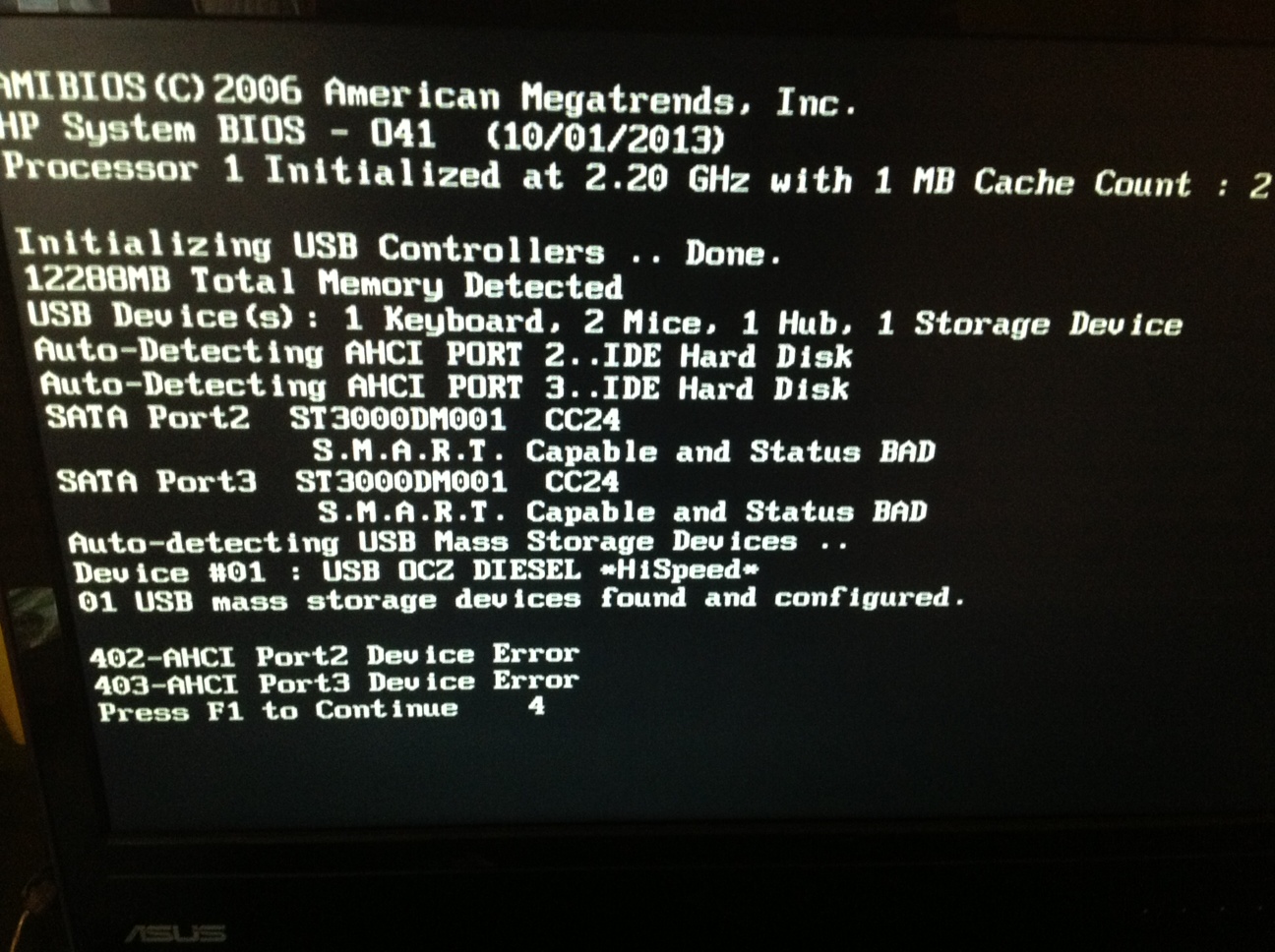

And here is a pic of the boot screen with a device error. This is while booting 9.2
