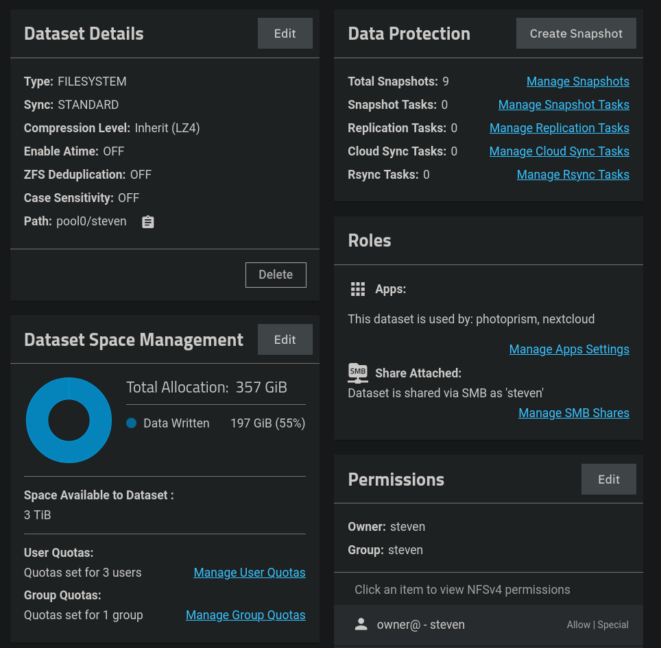

One of my datasets shows:
Total Allocation: 357GiB
Data Written: 197 GiB?
What's the extra 160 GiB? I checked the snapshots, there are some, but definitely not 160 GiB worth. The pie chart only has the Data Written section, which it says is 55% of the data. What's the rest?

Unless I'm extremely confused, that's not the issue. I'm talking about a dataset, not a pool. My other datasets have identical Data Written and Total Allocation.
I have 2 4TB drives in a mirror.

Okay, yes, we're getting somewhere. By running the command you said, I get
root@truenas[~]# zfs list -t filesystem -o space pool0/steven
NAME          AVAIL   USED  USEDSNAP  USEDDS  USEDREFRESERV  USEDCHILD
pool0/steven  2.80T   357G      159G    197G             0B         0B
So the space IS taken up by snapshots. However, I can't figure out why the snapshots are taking up all that space. If I run a command to look at the snapshots, it doesn't add up:

By my understanding, the numbers in the USED column should add up to 159G, but they're not even close.

Okay, I believe you. I currently don't know how to execute zfs command not as root because there's some issue with the Path when I'm not root. But regardless, what you're saying makes sense.
If I wanted to free up space, I should be able to tell fairly well which snapshots are the big ones based on the REFER column, right? Because that's basically telling me, if you were to revert to this snapshot, this is the size the dataset would be, right? If I deleted the first four snapshots out of the dataset, it should shrink the Total Allocated size down to about 197G, right?

Thanks for your help! I appreciate it.
The "Used by Snapshots" metric really ought to be in the WebUI. They have a nice pretty pie chart, but for all of my datasets it's just all one color, lol.
