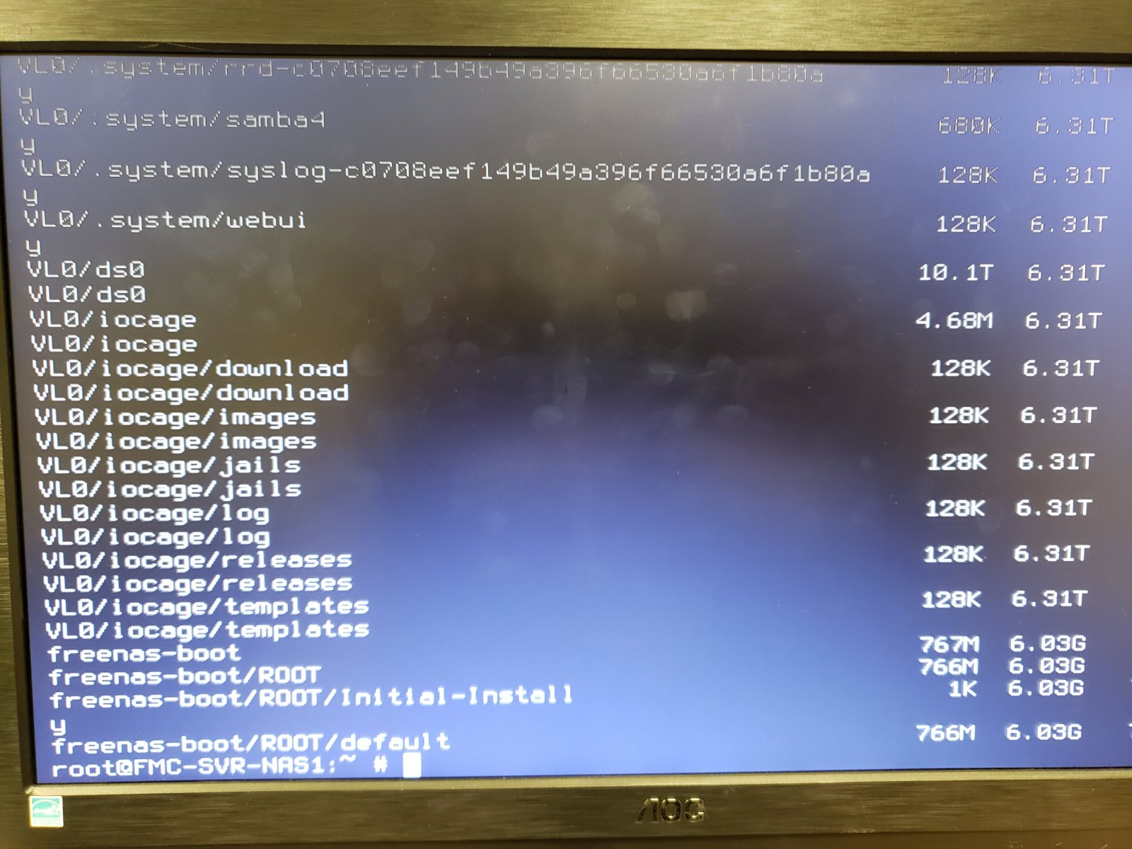

ok here is the results of zfs list, however, I am being told by a colleague that I am not explaining the issue correctly and wasting your time so I will make every effort to clarify what the conditions are.

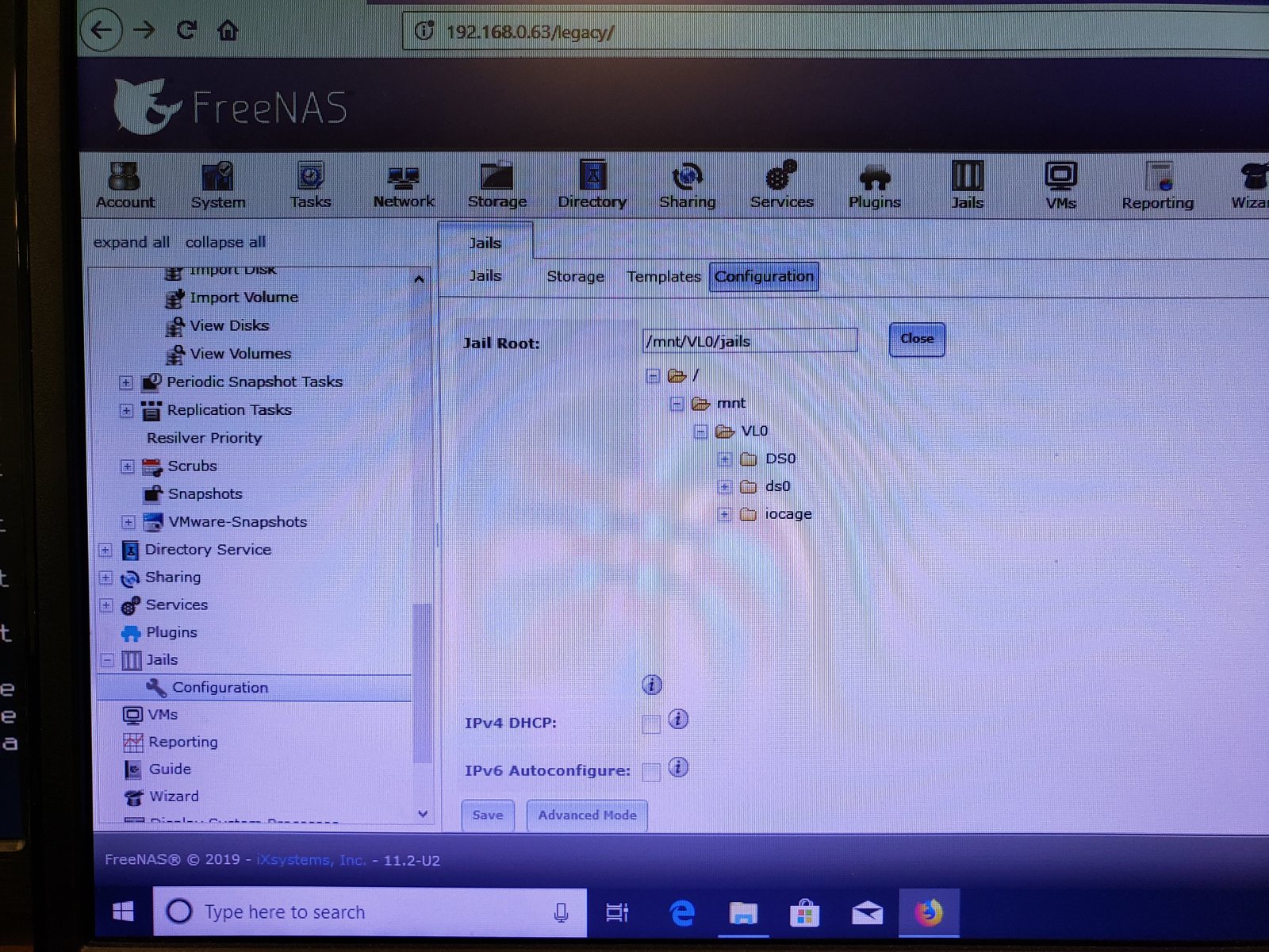

when we browse the SMB share on ds0 you can see some of the data roughly 700GB however the system shows 10TB used zsf list shows the same data amount but all of it in ds0 the only place I can see DS0 in in the jails (see second attachment) I will glady run what ever diagnostics are needed or answer what ever questions you have and it is only visible in the legacy interface.

9,700
It seems to me that ds0 is a directory, not a dataset (DS0 is a dataset).
can you cd to either (or both) of them?
cd /mnt/VL0/DS0
cd /mnt/VL0/ds0
if so, are the right contents in the respective areas?
It may make sense to just copy the data from ds0 to DS0 and delete ds0.
cd /mnt/VL0/DS0
cd /mnt/VL0/ds0
ok I can cd into both and the data looks right.
what next? since I cannot see them in a smb share I suspect I will need to use CLI/shell to move them is there a preferred way to copy all the data at once this is what I found for syntax

you could rename/relocate the dataset without moving files.
zfs rename VL0/DS0 VL0/new_name_for_DS0
