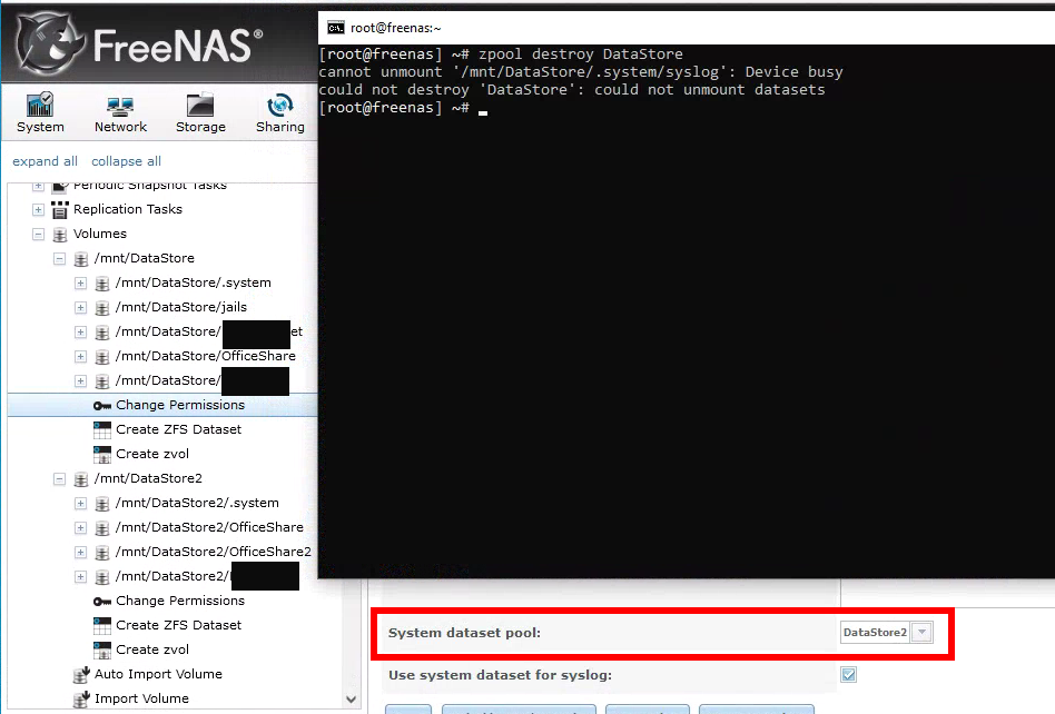

I am trying to remove a zpool with the following command:
zpool destroy DataStore
The following is the output of that command
cannot unmount '/mnt/DataStore/.system/syslog': Device busy
could not destroy 'DataStore': could not unmount datasets
Upon revision, I verified that a different pool has been set as the system dataset pool. How can I remove the zpool making sure I don't mess up my installation?
Screenshot of configuration

Don't use the cli, use the gui with freenas. You might need to move the system dataset to the boot drive. Read the manual for how to do that.
