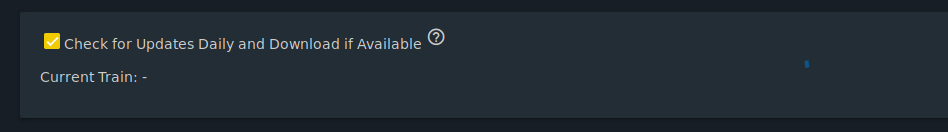

Hi. I did a fresh install of 11.2 from 11.2BETA3 and after successfully installing I then restored the configuration backup I had taken of 11.2-BETA3. I now have a situation where the Current Train is blank and the the update process just spins. I've checked network setting and I can get out to the internet ok.
I've attached a screen shot.
Can anybody tell me how to set the update server to the correct URL or where I need to do this? I don't want to have to manually update each time.
Paul

Yes. I had to manually enter my ISPs DNS server ip addresses in the network interfce setup of FreeNAS rather than relying on FreeNAS picking them up from the gateway default. I hadn't had to do that on 11.1 but I had had a similar issue when I had gone to 11.2BETA3 and had assumed that it was because it was a BETA version and ignored it.
It's all working now.
