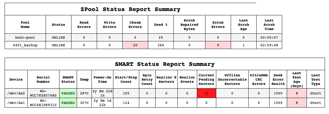

Greetings all!
I noticed there's quite a few threads on the subject but it appears that situations differ so I wanted to post my own findings in case someone could help. I noticed today an email from the script (posted here) showing something wrong with one of my drives. Here's the entire email:
Is this drive toast?
########## ZPool status report for boot-pool ##########
pool: boot-pool
state: ONLINE
scan: scrub repaired 0B in 00:00:07 with 0 errors on Fri Jul 29 03:45:07 2022
config:
NAME STATE READ WRITE CKSUM
boot-pool ONLINE 0 0 0
ada0p2 ONLINE 0 0 0
errors: No known data errors
########## ZPool status report for n40l_backup ##########
pool: n40l_backup
state: ONLINE
corruption. Applications may be affected.
action: Restore the file in question if possible. Otherwise restore the
entire pool from backup.
see: https://openzfs.github.io/openzfs-docs/msg/ZFS-8000-8A
scan: scrub repaired 0B in 02:59:48 with 9 errors on Tue Aug 2 02:59:48 2022
config:
n40l_backup ONLINE 0 0 0
gptid/c06e0530-9f83-11eb-9d33-000c29453d35 ONLINE 0 0 0
gptid/c6823b36-9f83-11eb-9d33-000c29453d35 ONLINE 0 0 20
n40l_backup/veeam@auto-20220730.1727-1w:/Lab/LabD2022-07-30T052101_68C1.vbk
########## SMART status report for da0 drive (Western Digital Red: WD-WCC7K5KY768S) ##########
smartctl 7.2 2020-12-30 r5155 [FreeBSD 12.2-RELEASE-p14 amd64] (local build)
ID# ATTRIBUTE_NAME FLAG VALUE WORST THRESH TYPE UPDATED WHEN_FAILED RAW_VALUE
1 Raw_Read_Error_Rate 0x002f 200 199 051 Pre-fail Always - 49
3 Spin_Up_Time 0x0027 184 158 021 Pre-fail Always - 5800
4 Start_Stop_Count 0x0032 100 100 000 Old_age Always - 105
5 Reallocated_Sector_Ct 0x0033 200 200 140 Pre-fail Always - 0
7 Seek_Error_Rate 0x002e 100 253 000 Old_age Always - 0
9 Power_On_Hours 0x0032 068 068 000 Old_age Always - 23889
10 Spin_Retry_Count 0x0032 100 100 000 Old_age Always - 0
11 Calibration_Retry_Count 0x0032 100 100 000 Old_age Always - 0
12 Power_Cycle_Count 0x0032 100 100 000 Old_age Always - 105
192 Power-Off_Retract_Count 0x0032 200 200 000 Old_age Always - 99
193 Load_Cycle_Count 0x0032 200 200 000 Old_age Always - 29
194 Temperature_Celsius 0x0022 122 116 000 Old_age Always - 28
196 Reallocated_Event_Count 0x0032 200 200 000 Old_age Always - 0
197 Current_Pending_Sector 0x0032 200 200 000 Old_age Always - 11
198 Offline_Uncorrectable 0x0030 100 253 000 Old_age Offline - 0
199 UDMA_CRC_Error_Count 0x0032 200 200 000 Old_age Always - 0
200 Multi_Zone_Error_Rate 0x0008 200 200 000 Old_age Offline - 0
No Errors Logged
Test_Description Status Remaining LifeTime(hours) LBA_of_first_error
Extended offline Completed without error 00% 23589 -
Short offline Completed without error 00% 23676 -
########## SMART status report for da1 drive (Western Digital Red: WD-WCC4E1PE9310) ##########
1 Raw_Read_Error_Rate 0x002f 200 200 051 Pre-fail Always - 0
3 Spin_Up_Time 0x0027 187 175 021 Pre-fail Always - 7650
4 Start_Stop_Count 0x0032 100 100 000 Old_age Always - 124
9 Power_On_Hours 0x0032 067 067 000 Old_age Always - 24136
12 Power_Cycle_Count 0x0032 100 100 000 Old_age Always - 118
192 Power-Off_Retract_Count 0x0032 200 200 000 Old_age Always - 112
193 Load_Cycle_Count 0x0032 196 196 000 Old_age Always - 12329
194 Temperature_Celsius 0x0022 122 115 000 Old_age Always - 30
197 Current_Pending_Sector 0x0032 200 200 000 Old_age Always - 0
No Errors Logged
Extended offline Completed without error 00% 23837 -
Short offline Completed without error 00% 23923 -
