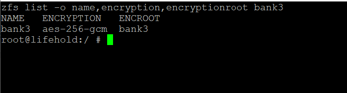

What is the output of:
zfs list -o name,encryption,encryptionroot bank3
EDIT: Are you using the Legacy (GELI) encryption or the new ZFS encryption?

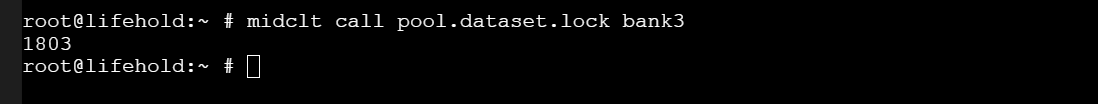

Still no luck. I attempted
midclt call pool.dataset.lock bank3
as well ass
midclt call pool.dataset.lock bank3/bank3
Attached is the output you requested. Drives are now using latest ZFS Encryption. Both commands gave the same result. Process number output and no result.

Oct 22, 2019
3,641
Is there actually a dataset bank3/bank3?
No matter how much time passed since you issued the command, the dataset remained locked?
Is there anything using the datasets? Currently opened shares?

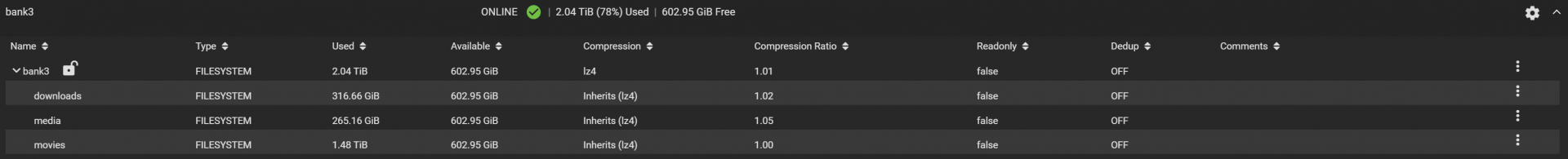

Don't know if this helps but the structure in the GUI looks like this. I created the pool in the GUI, and it automatically added an encrypted dataset to it. Then I made child datasets below that for organizational purposes. It does have shares attached to it. I will attempt to stop the shares and use the lock command, but I can tell you that if I use the GUI menu to lock the share it does not have any issue locking it even with the shares running.
Edit: Also 40 mins later it still hadn't locked. Just tried it again with the shares to that pool stopped, and it did the same thing. I'll give it some time to see if it actually locks.
