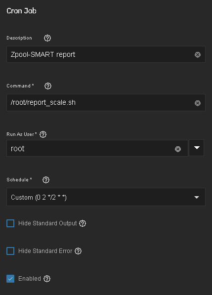

Attached screen capture.
1. in root directory: ./report_scale.sh
2. /root/report_scale.sh
3. root
4. script
1. /root
2. -rwxr-xr-x 1 root root
3. #!/bin/bash
