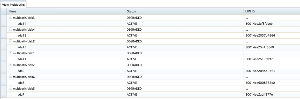

ccdanieldb
Oct 26, 2016
29
Hello. I am new to FreeNAS and I think this post will solve my similar multi-path problem. My question is about step 2 above. What should go in place of "x". I have 8 drives and 7 of them are now being looked at as multipaths (photo attached). Do i replace x with multipath/disk3 or ada14 or both.
Thanks for your help.
ccdanieldb
Oct 26, 2016
29
Solved. It is disk. i.e. gmultipath destroy disk3. I have access now. I had to destroy all multipaths then restart a few times before i could get the import to take. Thank you very much LostFate. I also want to add that this happened when i decided to change my connection for my two external 4 bay hard drive enclosure from esata to USB3.0. Be aware that this change can caused this multipath problem.
