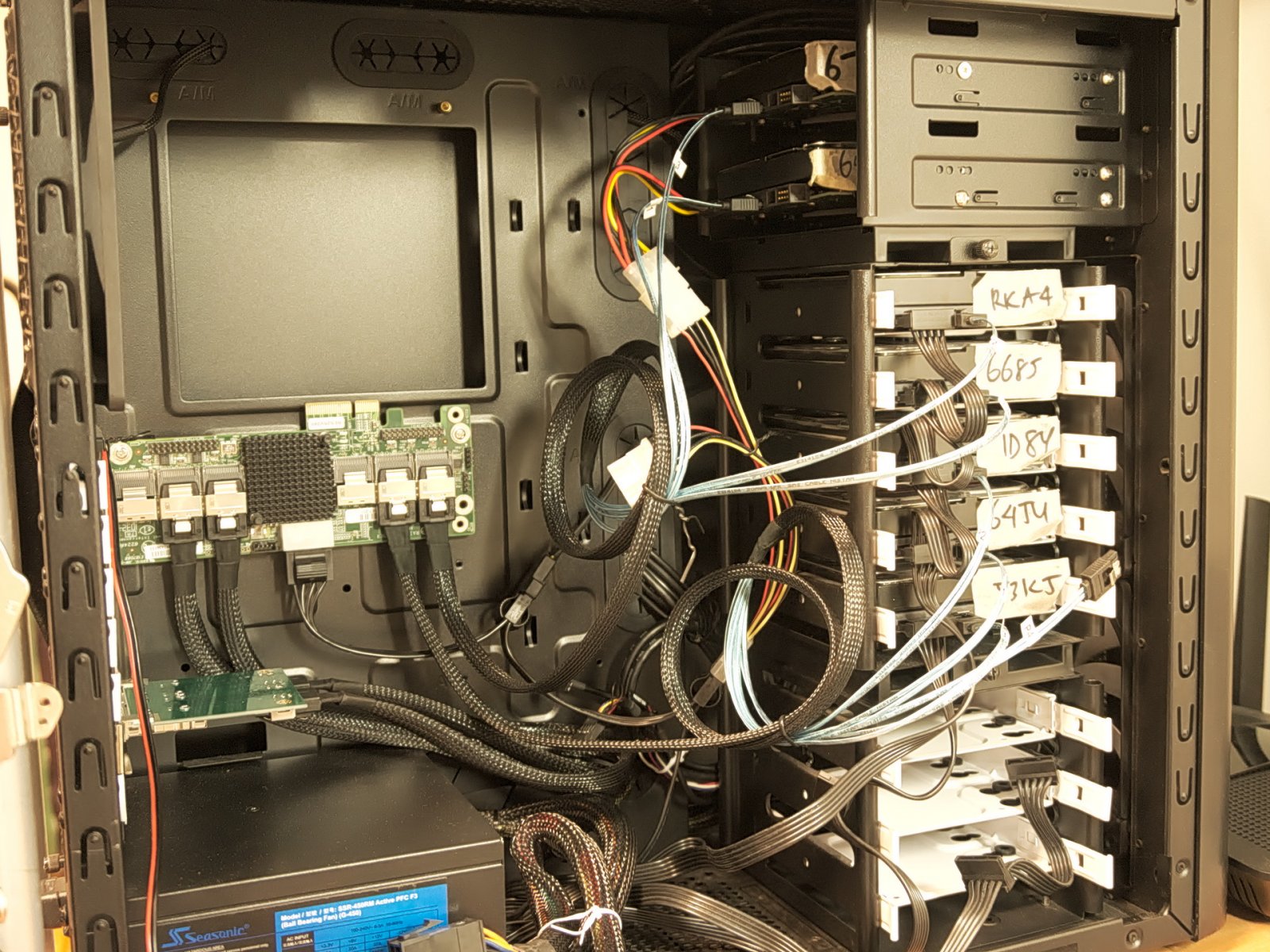

In your situation, you will probably need to identify the drive by serial number.
Many people put labels on their drives to help with that.
