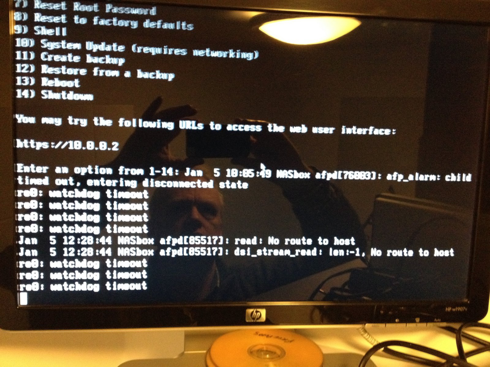

Hi Everyone,
I loose access to FreeNAS when copying files
Have to reboot to get access.
Please help.
Thanks
Andy

Hi Hope this is enough below
Build FreeNAS-9.3-STABLE-201512121950
Platform AMD FX(tm)-4300 Quad-Core Processor
Memory 15843MB 2 x Crucial 8GB DDR3 CL9 12800 Sport XT
Motherboard: 78LMT-S2 - no add ons

It looks like your network card is hanging up. I'd google for re0 (realtek?) and freebsd hang to see if there is anything that can be done. Otherwise, pickup a cheap intel nic and be off to the races.

As @depasseg suggested get an Intel Pro/1000 CT NIC. It costs about $30 USD.
There are a few users on the forum using a similar CPU, but use a different mobo and ECC RAM. I think most have had to upgrade to an Intel NIC to resolve issues with the onboard Realtek.

My value hardware was purchased to meet the minimum hardware requirement. If Reatek ethernet is not compatible with FreeNAS it would have been really useful it it was stated in the minimum requirements.
I have will ask a friend to buy and send and import a Intel NIC as they are like rocking horse **** over here.
Its also a real grind that the system partially works, hangs, requires rebooting. It would be better if it did not support Realtek at all, as I have been battling to get the system stable for weeks...
