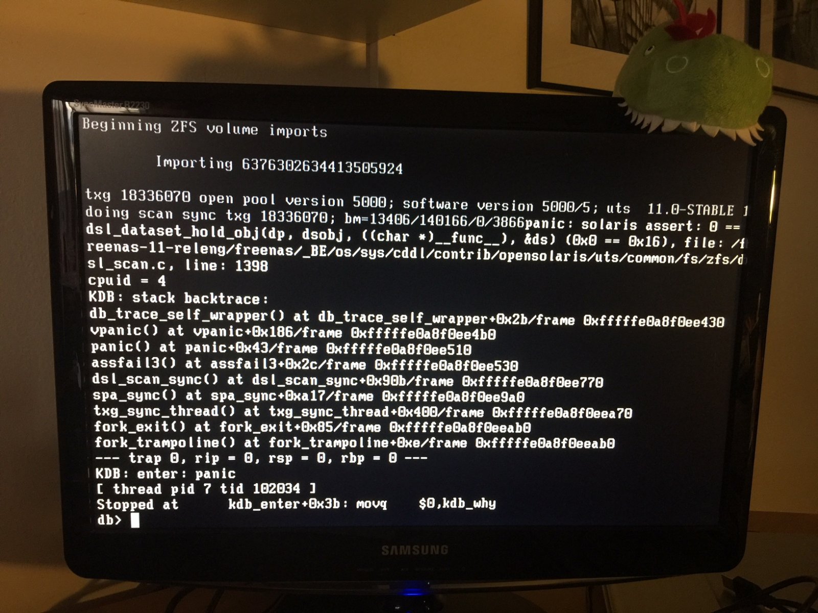

Hi Gents,
i'm facing up with a serious issue with Freenas 11, on boot up it crash on "Beginning ZFS volume imports . I really appreciate your help in order to solve this issue. My family is suffering like stone age due to lack of multimedia :mad:.

Try installing the same version on a different USB stick. If that boots, you can restore a copy of your previously saved config.

If that doesn't work, the pool may have some kind of corruption. A memtest should be run on the system. After that, the next step would be attempting to import the pool in readonly mode.

Thanks for replies, i tried to import from another system as Dlavigne said but same it reboot during importation ... i ll try men test

Thanks for reply, I've done memtest for many hours and no errors have been highlighted; what can happened ?? how do i recover the pool ?

The crash error you posted showed an assertion failure. (0 does not equal 16)
That can indicate that a single bit flip happened and went into the metadata. Was the RAM ECC? In any case, the data doesn't make sense and this generates a panic.
You want the drives in a system that will not try to import the pool on boot. Once you have a system that boots up without trying to access the pool, you can try a read-only import from the command line/shell. Readonly avoids some areas of the pool metadata; maybe it will avoid this problem.
zpool import -o readonly=on poolName
If it says the pool was imported on another system, try zpool import -f -o readonly=on poolName
If that succeeds, then you should be able to get the data off the pool before you destroy it and create a new one.

no i'm not using ECC RAM, i'm trying right now the procedure you suggested... i hope it will work ..

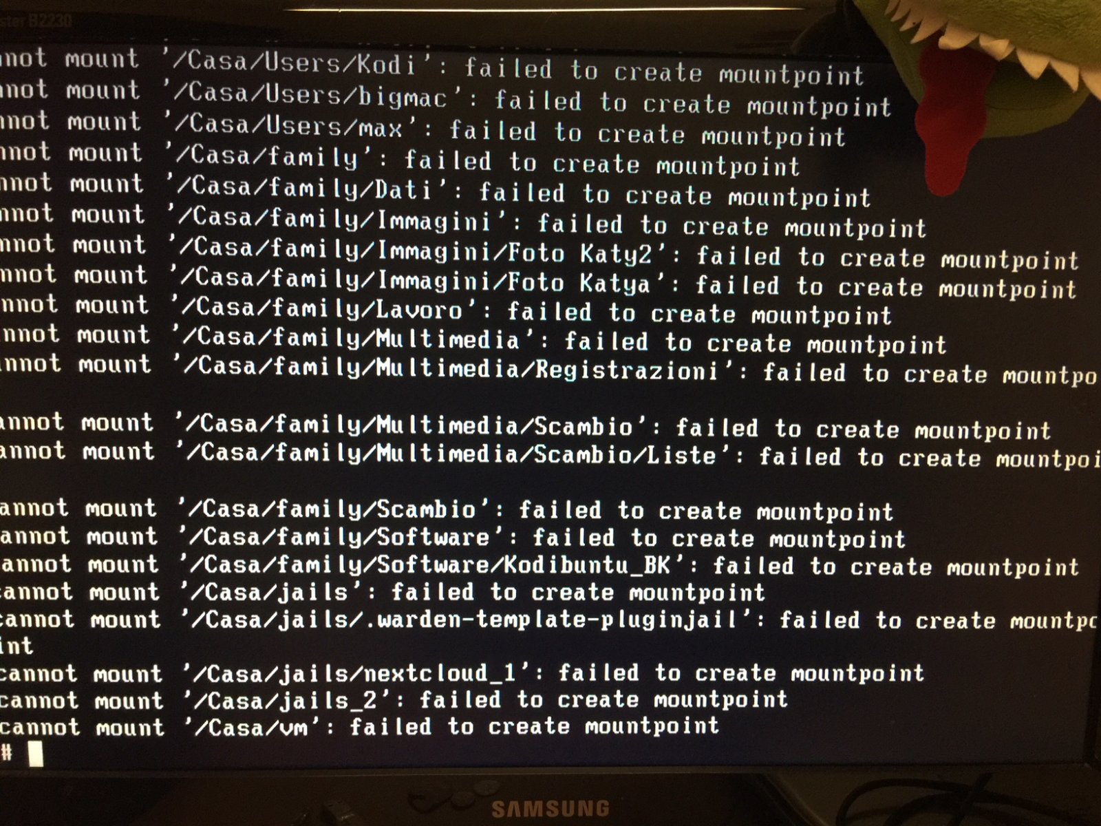

No way it says "Cannot mount / ...." i think my pool is gone

rs225
Jun 28, 2014
878
Try zpool import -o readonly=on -R /mnt poolName or the -f variant if needed.
If those errors don't occur, look in the /mnt directory to see if data is there.

No way i got in both case errors, luckly i have an exact copy of pool and i've already restored data. How do i prevent this kind of errors, my MB doesn't support ECC ?
