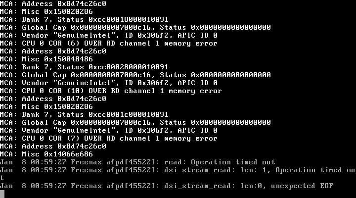

The machine been running for a few days now. I've been transferring my media in the meantime and I notice this on the screen. What is this about? Should I be worried?

I just got this message again. What to do?

Here's another screenshot of today error:
I'm actually doing backups every week of all my data. Im using Karen replicator to do the job. Any app recommendation for backing up?
The re-silvering happened once. I don't know if that was due to the shifting of the memory sticks. I read that re-silvering takes days an days when you have multiple terabytes, Well I have 12x 6TB drives and it only took about 10-15 minutes that time.
The memory model is Crucial 64GB Kit (16GBx4) DDR4 2133 MT/s (PC4-2133) CL15 DR x4 ECC Registered DIMM 288-Pin CT4K16G4RFD4213

It only has to touch the changes not every bit. I keep watching your memory error wondering if we have a bug or actually a bad dimm. Can you locate and pull the bad one somehow and see if the problem disappears? Not sure how exactly to interpret channel one bank 7, but has to be a way to figure it out. Not sure if you checked the ipmi logs, but ecc errors should be logged. Look into mcelog as well.
I'd be tempted to Install a single dimm at a time and run it to see if the error popped. Current server load should be fine at 16GB, if it isn't run two sticks. Will also give you a feel for memory requirements and differences.
Wish I could say I've seen this one, but I haven't. Normally bad ram for me has been an unstable box, not a polite error.

You are getting them far too frequently to be random chance. You've got something bad in your machine. Most likely a DIMM but it could be something else like motherboard, bad power from the PSU, etc.
The idea of running a single DIMM at a time is exactly what I'd do.
ECC RAM with a single-bit error should throw polite errors exactly like the one you are seeing. Multi-bit errors should halt the system though.

I've checked all my data on my backups and they all seem to be OK. I will remove them this week as I have the chassis in the rack already. Is there a way for me to determine what memory stick is Bank 7?

As for how to determine the memory stick for bank 7, not sure. You'd have to contact Supermicro.
