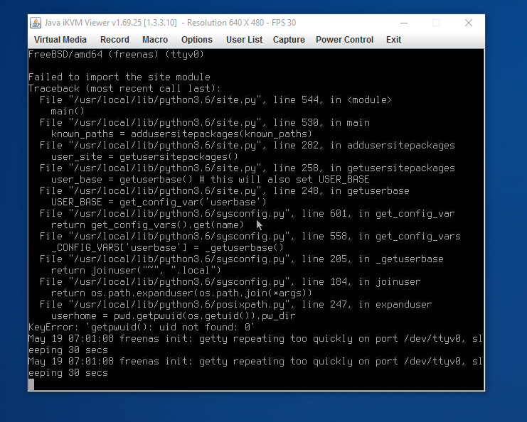

This is the error i get when booting 9.10.2, 9.10.3 or FreeNAS11RC2

Corral boots up fine though.
Did you try after the 9.10 installs? Could be a bad install or failed USB.
Hey, I' at the exact same decision and I have the same error messages when trying to boot up 9.10.2, Corral 10.0.4 boots up fine. Since there is no alternative to boot up I consider to do a fresh install with 9.10.2-U3. So far my FreeNAS just worked, therefore I'm not experienced with re-installation. How and what should I backup? Thanks in advance! ;)
I came from 9.10.2 updated to Corral, updated Corral two times to version 10.0.3 and 10.0.4 and then i tried to go back to 9.10, Nightlies and FreeNAS11. All on the same boot device. Since i did not do anything special to my FreeNAS installation i figured everybody who updated to Corral should be in the exact same situation as i am, so i am still a bit disappointed that there is no real help thread dedicated to exactly that situation.
It would be really helpful if somebody can answer my questions from my initial post, since i am still not quite sure what to do right now.
You can't switch release trains like that. You have to reinstall it roll back using boot environment. Also any time you move to nighties you're 100% on your own since those are for testing only.
I installed 9.10.2 from scratch and imported my pool without any issue. The only thing i did in Corral was set my volumes to the "restricted" acl mode.
You should give that a try as well, and use a new boot device and keep the Corral one for backup puposes.
