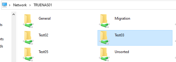

When accessing my TrueNAS via "\\truenas01" from a Windows 10 computer, shares to which the current user has neither share nor file permissions are visible despite Access Based Share Enumeration being enabled.

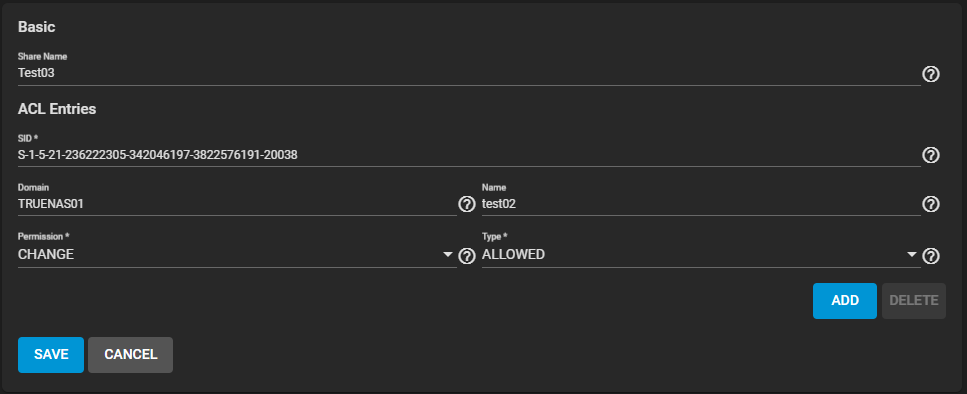

I created a share named Test03 targeting the Test03 dataset:
The Share ACL is configured so that only the test02 account has access:

My understanding is that with the configuration above, user test01 should be able to access \\truenas01 and the Test03 share should not be presented. However:

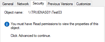

And just as a sanity check, I evaluated the share permissions on the Test03 folder through Windows Explorer to confirm that no share permissions are present:
File permissions deny access to the share as expected.

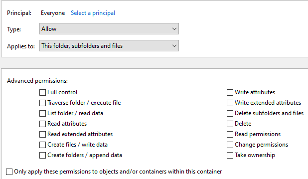

I have noticed that despite not being configured in either share or file permissions, the Everyone user is present on all files and folders with no permissions:
When I attempt to remove this access, it is immediately re-applied.
I suspect this might be the root of my issue. If Everyone is being applied to all files and folders, despite having no permissions, SMB might consider that enough access to present the shares to members of Everyone. If true, this would effectively make Access Based Share Enumeration useless until the Everyone role is removed.

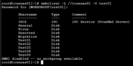

Yes, Test03 shows up there as well.
I'm having some issues copying all of the text out of the web shell, so instead I took a screenshot of the command and its output:
I'm not sure it matters, but this was run from the web shell of the same TrueNAS system where the shares reside.

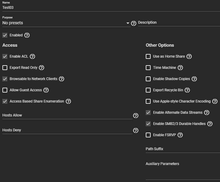

Try removing the "Browsable to network clients". Perhaps it contradicts the access based enumeration because for *nix everyone is literally everyone and for Windows its \\ThisPC\Everyone. Maybe the nobody group is in everyone?

Removing "browsable to network clients" did hide the share for test01. It also hid it for test02, though, which should be able to see it. My understanding is that this is the expected behavior. I don't think enumeration comes into play at all if the share isn't browsable in the first place.
Your explanation that *nix taking Everyone as literally everyone being the root cause for why SMB enumerates the share for all users makes sense to me. I would think this would have been tested when the checkbox for Access Based Share Enumeration was implemented in the UI, though. So it could still be something I've done wrong somewhere.

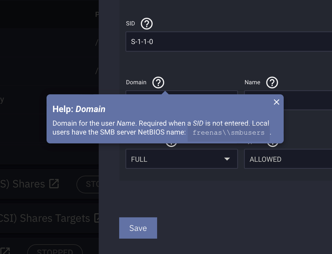

Black_Duck
Oct 8, 2022
61
Thanks andos.
Yes, I was aware that the share ACL controls visibility and had already confirmed that I had that configured correctly.
Glad to to read you guys are on top of it. Will wait patiently for 22.12.1
By the way, the Help on Domain in the Share ACL shows “freenas” when it should show “truenas“
