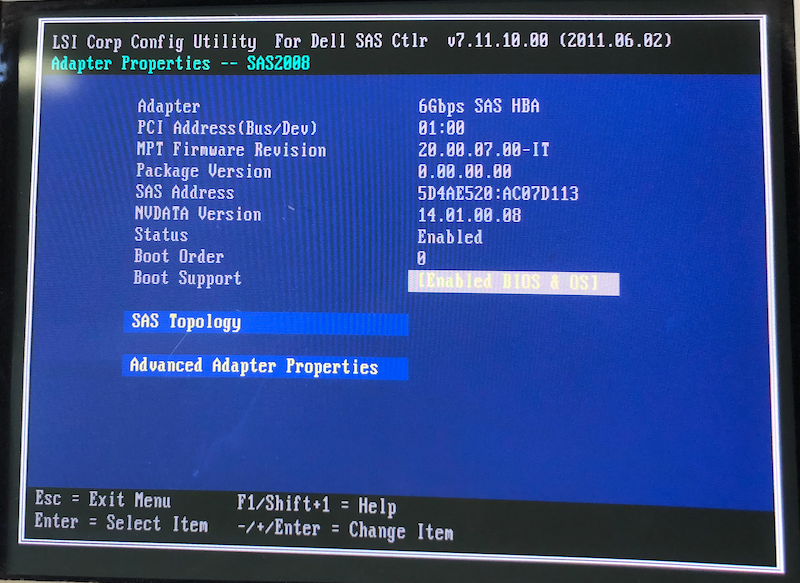

Ciao a tutti ho acquistato un
HBA DELL H310 6 GBPS SAS HBA FW:P20 9211-8i IT modalità ZFS FreeNAS unraid 2 * SATA SFF
Installato su scheda madre Supermicro x11ssl-f, ho collegato al HBA un hdd ma non lo vede,
Devo settare qualcosa nel bios?
allego screenshot
Hi everyone I bought a
DELL H310 6GBPS SAS HBA FW: P20 9211-8i IT ZFS mode FreeNAS unraid 2 * SATA SFF
Installed on Supermicro x11ssl-f motherboard, I connected a hdd to the HBA but it doesn't see it,
Do I have to set something in the bios?
I am attaching screenshots

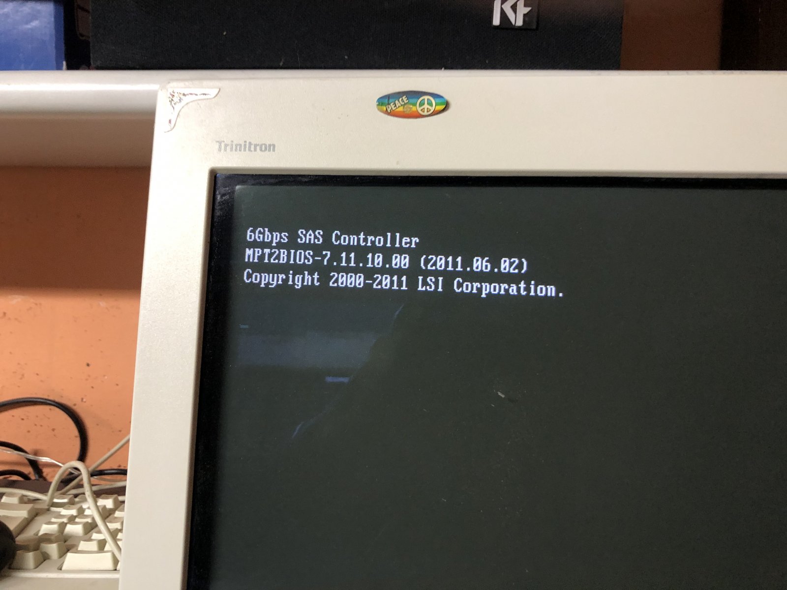

Now it works I replaced SAS SATA cable,
A problem takes 5 minutes more to start
Fermo on this screen
