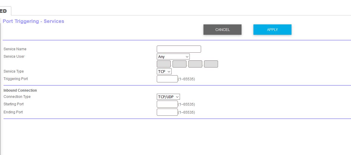

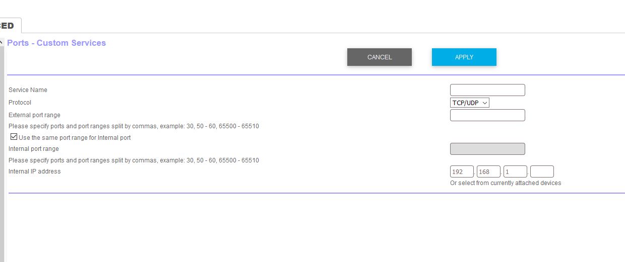

I believe my VM has the same IP as host with a port tied to it. To clarify, my FreeNAS has an IP of 192.168.1.156 and I VNC into the Ubuntu VM with VNC Viewer at 192.168.1.156:5649. To answer your question, I am port forwarding to the 192.168.1.156 and using the suggested Minecraft Bedrock port. I had also tried using this with port triggering. Is there a way to specify the port of the VM? I will include some screen shots of my router's port forwarding/triggering setup pages.

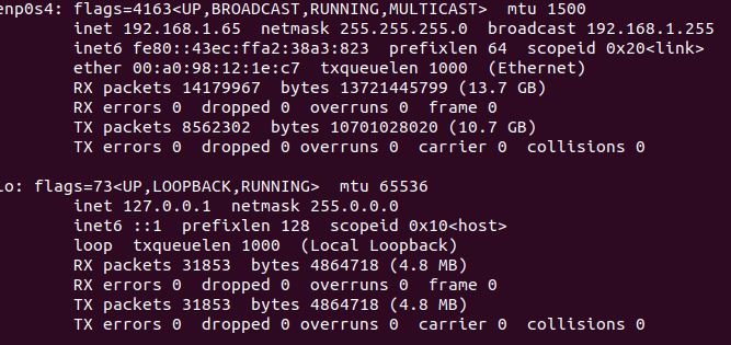

Okay. I tired that and attached is the result. I see two IP addresses 192.168.1.65 (this is the IP of my PiHole DNS) and the other is 192.168.1.255. I assume it is the one ending in .255?

I did try the .255 with no luck.
The second part of the return "flags" doesn't sound good. Do I have something setup incorrectly within the VM?

No, your VM IP is 192.168.1.65.
