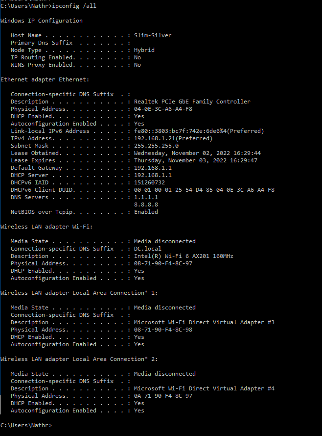

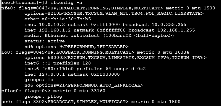

Here is the network configurations

Well, it looks like they have the 192.168.1.0/24 sub-net in common. However, the MS-Windows box is using DHCP which may cause it's IP to disappear when dis-connected from the main network.
Make sure when you perform the direct connect, you use the NAS IP of 192.168.1.2 because the other, 10.0.10.2, won't be available.
