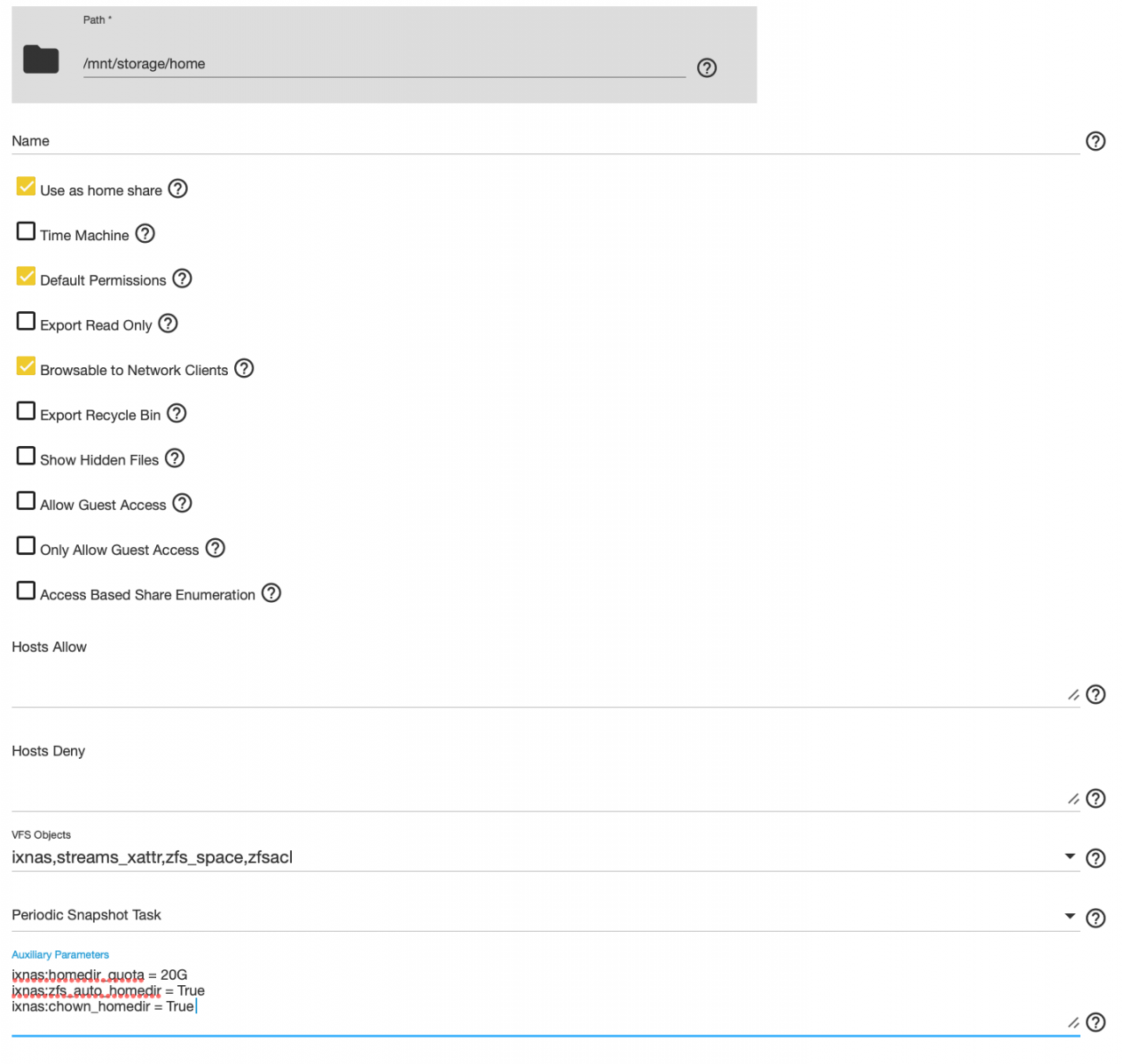

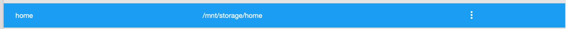

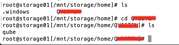

Hey
Im testing this now, and the ixnas:zfs_auto_homedir doesn't seem to work with AD ?
so the DOMAIN folder is created, and then under there the user folders pop up, but no new data sheets is created.

There's a bit a configuration that needs to happen with that option. The default behavior for AD-based home directories in FreeNAS is to create a _directory_ with the "pre-Windows 2000" domain name and then use pam_mkhomedir to create the user directories. In this case, you'll probably need to first create a _dataset_ with the aforementioned domain name, then turn off "obey pam restrictions" under services->SMB. Do note that in a large AD environment you may encounter UI issues as the number of datasets scales goes up. If you have more than a hundred users, it may be better to do the userquotas rather than the auto homedir.

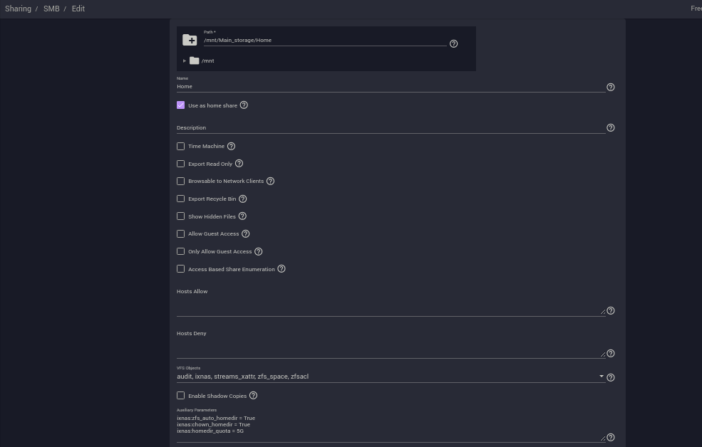

Hello. I have a trouble just after update to 11.3-U2. I've mentioned that now user home folders are created instead of user's home zfs datasets.
Config was not changed a long time (see attahced image).
Could someone help me to figure out what is wrong? Maybe something changed in new version?

Might be that pam_mkhomedir is generating the directories before we enter ixnas_vfs_connect(). Try setting "obey pam restrictions = no" as an auxiliary parameter under Services->SMB.

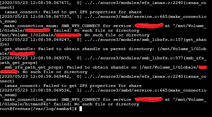

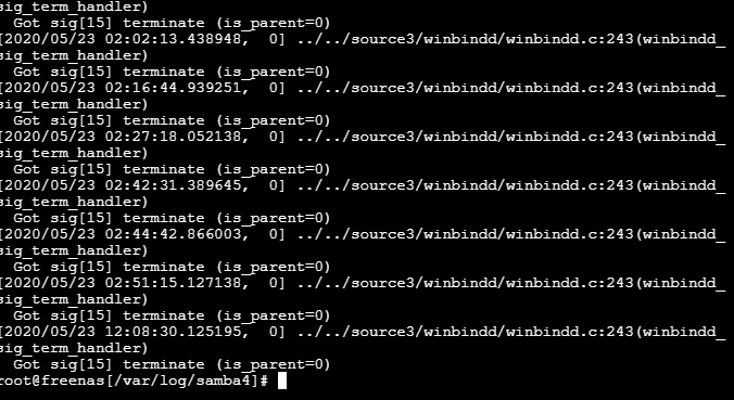

hello, I had the same problem, only that I have never seen it work, I am new to freenas but I followed the manual procedures and I cannot create datasets at login but only shared folders, not accessible with the name of the logged in user.
I am attaching the two log files after windows denies me access to the folder .
when i get this error in the log file log.wb-FREENAS,
i also get the following error in the log file log.smbd:
my question is if this is always a bug or i am wrong
