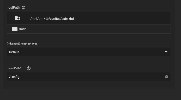

When trying to mount a volume into /config i get this error. I want to safe my config files outside the container (for obvious reasons).
What is going wrong here and how can I fix it? thanks in advance.
middlewared.service_exception.CallError: [EFAULT] Failed to install chart release: Error: Deployment.apps "sabnzbd" is invalid: spec.template.spec.containers[0].volumeMounts[1].mountPath: Invalid value: "/config": must be unique

That error means you already have a dataset to mount to /config. You can't have multiple volumes / datasets mounted to the same endpoint, I.E. /config, inside the container. Otherwise they stack on top of each other and the one mounted first is unused.
You'd instead mount each datasets to a sub-directory, I.E> /config/myfiles & /config/myconfig or something similar to that.

Can you share with us what the host volume configuration page looks like in this instance? The issue is that you already have a host-volume on config, and it think's you are trying to mount a 2nd host volume on top of the same one...

Not sure if you mean this, this atleast what I try.

answered my own question after looking at the screenshot closer
your using the truecharts sabnzb install,
By Default it creates a PVC based Storage that automaticly mounts to /config (in the case of sabnzbd)
so you cant attach a second hostpath storage to /config
you can change the PVC to a hostpath. but thats an advanced config not really suggested to do as it breaks the rollback feature, and would break some features in the future. and some apps may not like it in a k8s environment

yes. with truecharts all config paths default to PVC, if you want to use an external path you have to change it.
I've not messed much with the big blue button launching, but its fairly limited.
honestly i stick with the PVCs to avoid issues.
for apps like sonarr/radarr I can just use their internal backups and download them after I make changes/before an upgrade of the image
sabnzbd is just a single config.ini file that needs to be copied. pretty easy to shell in and copy it once I'm done making changes
for apps that arnt as easy (jellyfin), i've taken to mounting an additional host path called /configbackup then shell in and cp the config files to it.
and to edit configs. its not that difficult to shell in and edit a config file if needed.
I havent had to use the Rollback yet my self. but it is kinda nice to know if an app like Sonarr, on its next update reconfigured its DB, but the update was broken, i can just rollback and it would rollback the the DB to its pre upgraded state as well. all with out worrying about my last backup,
with out a PVC that would break.
For something like nextcloud that's really touchy. that rollback feature will be a must i'd say
of course as a backup admin I do deeply understand the desire of file level recovery on top of snapshot recovery
just as of note of clarification the PVC is outside of the container. so its not going to get wiped on an update, the PVC just is not as easily accessible as say shelling in to scale and cd /mnt/pool/path
But it does get deleted if the app is deleted. not 100% sure if a snapshot lingers around or not that could be restored. that's a question to look in to my self

@shadofall is correcthere :)
Thougb there is another backup option:
you can also use local zfs send and zfs recieve, to copy datasets on a fixed schedule to a "backup dataset" that sits out of k8s control, in case you're worried of k8s blowing your stuff up :)
