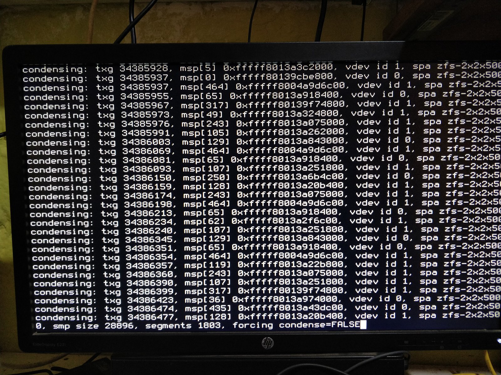

I am now stuck in a condensing nightmare. The microserver has been cranking now for over two weeks.
It shows on the screen the following line:
condensing: txg (sequence of 8 numbers), msp[2,3 numbers] 0xfffff(then varying number letter combos totalling 11), vdev id (0 or 1 ), spa zfs - (drive name)
The sequence of 8 numbers appears to be gradually increasing - but man when is it finished?
I've got a screen shot to possibly explain better?
Any advice? I'm thinking that I might have to go back to 11.1 on the usb drive - reboot and try and receover my data that way? (read into this the wife will kill me if 30 years of photos are gone)

I see this every time I reboot my server, so I don't think you should be worried about it. I have a powerful server but it can take a minute or two to pass this state sometimes. I think this might be something related to the cache being read.
However sticking there for 2 weeks isn't normal.

i didn't think 2 weeks is normal. As far as I can tell it is due to the issue I was having with almost zero space left on the drives. Just so I have an idea - what should the txg set of numbers get to? Is it supposed to match the allocated terabyte space?
That's your issue. There's many warnings online and on this forum about filling a ZFS pool to capacity. Unless you can truncate some files to clear up some space this is likely not going to resolve itself.

Before I try and go this step of using shell to delete files. The numbers slowly going up? What should be the crucial number that it gets too? if i'm not clear here I mean - if I have two 2Tb disks that are in mirrorwith two others then the total memory capacity is under 4Tb? So these TXG numbers should not exceed this?
