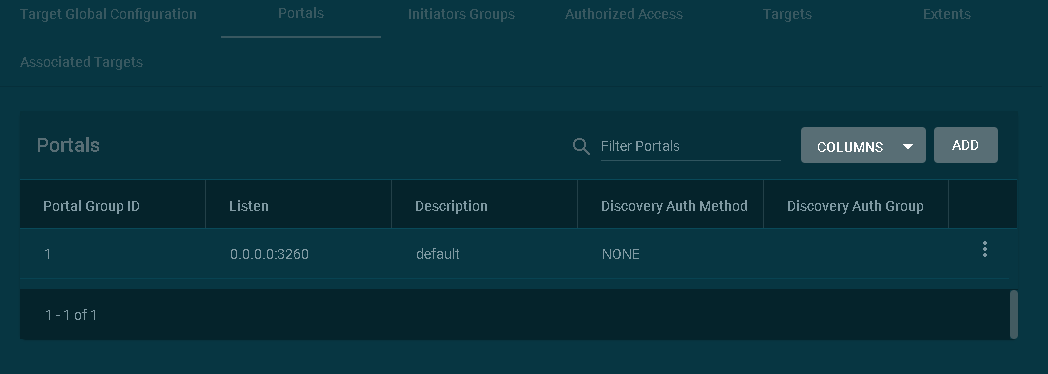

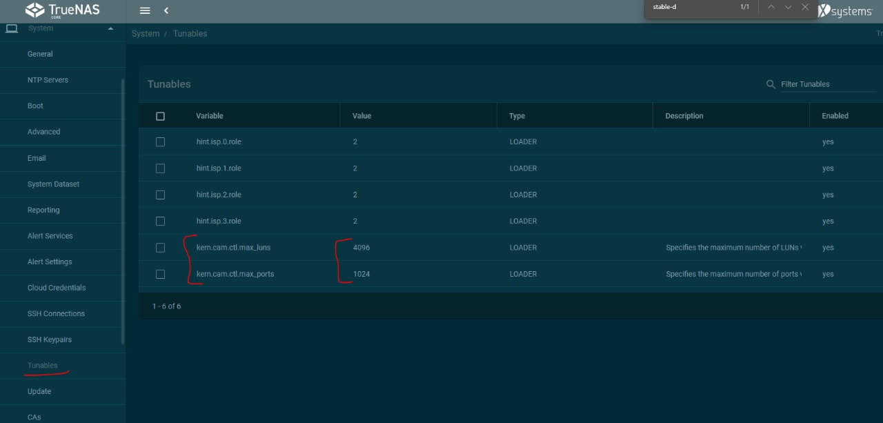

Hello,
I have a Storage TrueNAS-12.0-U8 ( virtuallized Hyper-V) with a pool and iSCSI sharing. It was working fine until few hours ago:
Apr 7 08:28:07 truenas 1 2022-04-07T08:28:07.207272-07:00 truenas.mycompany.com.br ctld 1244 - - child process 18341 terminated with exit status 1
Apr 7 08:28:07 truenas 1 2022-04-07T08:28:07.209004-07:00 truenas.mycompany.com.br ctld 18342 - - 172.30.0.87 (iqn.1994-05.com.redhat:23c3b778d047): error returned from CTL iSCSI handoff request: cfiscsi_ioctl_handoff: target not found; dropping connection
Apr 7 08:28:07 truenas 1 2022-04-07T08:28:07.215481-07:00 truenas.mycompany.com.br ctld 1244 - - child process 18342 terminated with exit status 1
How can I Fix it? Thanks

We solved it. It was a FreeBSD limitation to 256 LUNs.
References:
