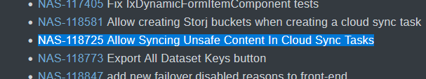

I wonder why I don't have the option to allow this in the gui though, as in these patch notes for scale 22.12.0, it says "Allow Syncing Unsafe Content In Cloud Sync Tasks" (I'm on SCALE-22.12.0)
