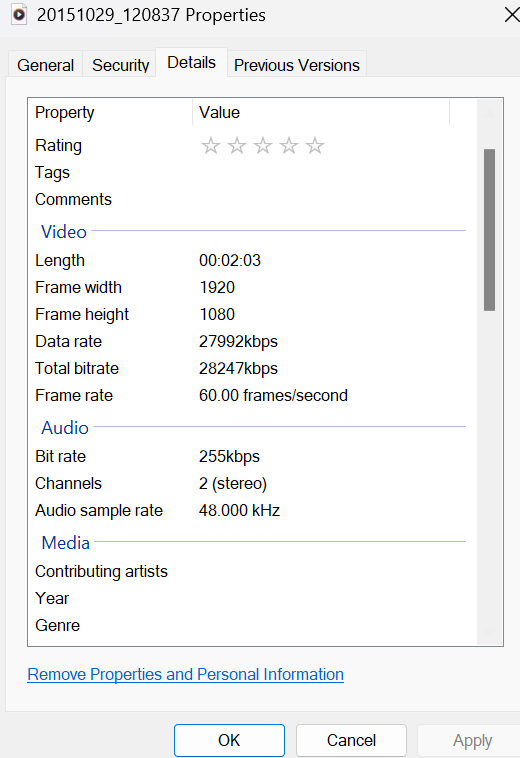

Here are the metadata the file has on Egnyte and when download from Egnyte:

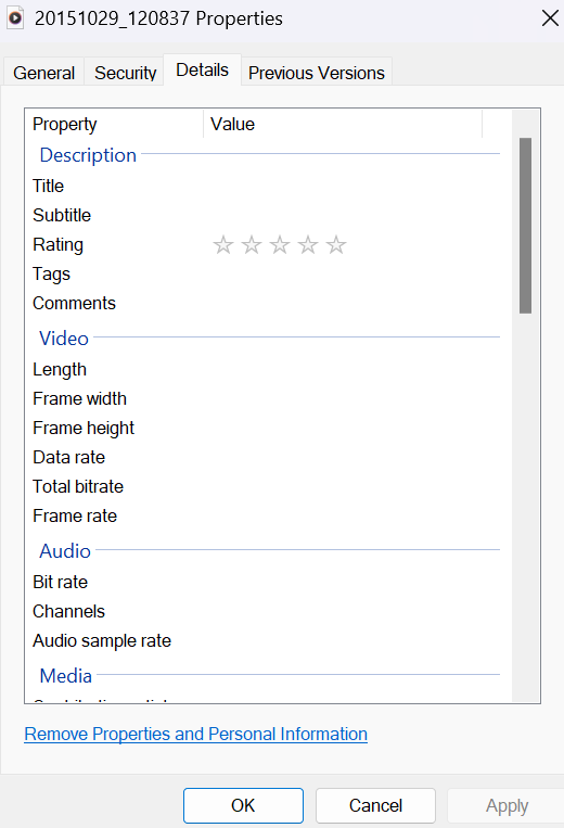

Here are the metadata the file has in TN after sync:

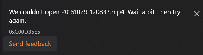

When I try to open the file from trueNas after sync automaticly I have following error:
The file cannot be opened.

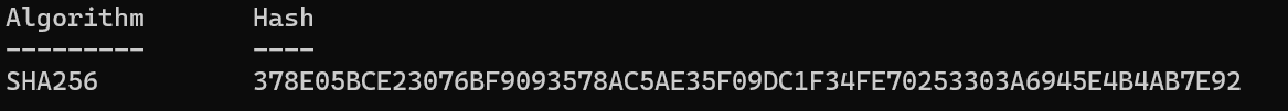

What is the SHA256 sum (hash) of the file when it's transferred via SFTP/cloud sync, vs when you manually download it from Egnyte to your PC and again manually from Egnyte to TN?
It would seem unusual that the use of the cloud-sync task would result in failure.
Crekate
Jan 2, 2024
10

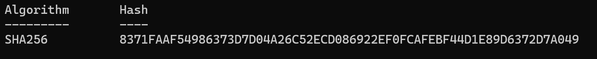

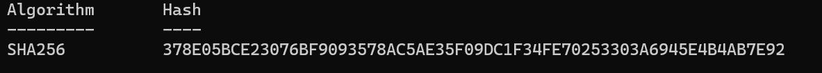

Here is has for the file copied with cloud sync:
Here is from Egnyte to PC:
Here is from Egnyte to TN (manually):
The first one differs.

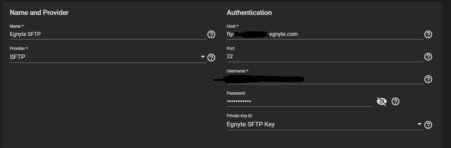

Here is the setup I have in TN:
The same host, port, username and password I use in WinSCP and with WinSCP the file is copied corretly.
