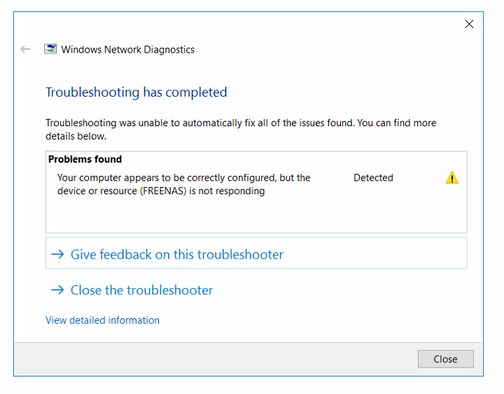

My FreeNAS has a static ip in my home network (192.168.0.4).
I can connect with all my Windows 10 pc's to the FreeNAS unit when the NIC in the pc has a static ip address.
I cannot connect with all my Windows 10 pc's to the FreeNAS unit when the NIC in the pc has a dynamic ip by DHCP. DHCP pool in the router ranges from 192.168.0.200 - 192.168.0.250. I can ping FreeNAS from the pc's. Disabling the firewalls in the pc's does not help.
Windows give the error message as shown in the attached file.
I do not know with which FreeNAS update it started.
Any idea?

Problem solved. Your question about 192.168.0.209 made me think. This is a media box from UPC/Ziggo I recently added and it caused the problem. DHCP on this box was also enabled.
It had nothing to do with FreeNAS.
