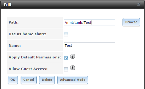

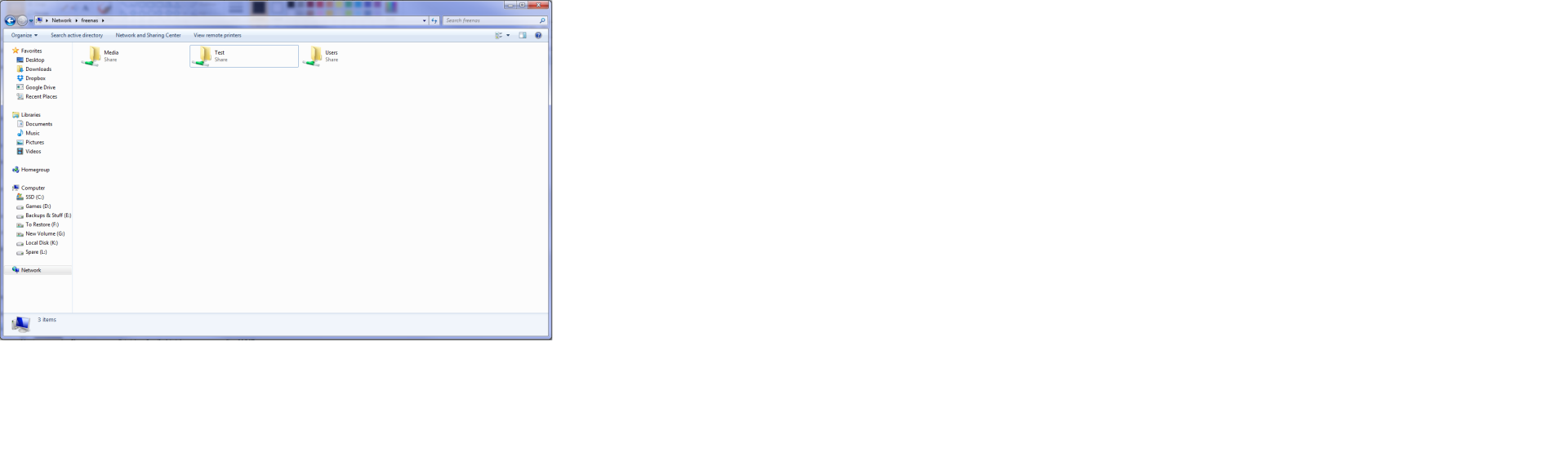

Hi, I've currently set up a few shares for Windows and given permission to my groups (see attach). Unfortunately, I can never seem to authenticate the user (guest access works). I am using Samba 4.1 as my AD DC.
I can see the share folders just fine but am unable to enter the folder if I click on them. It asks me to login saying my credentials are invalid. I've since tried every set of credentials for every user (including the administrator) to no avail. I can access FreeNAS through Computer Management and see that all shares are marked as Full Control for Everyone which is fine until I can get in the share. I've also gone into the shell and used wbinfo and all it's variations and can see the users, groups, user authentication and trust all return successfully.
Errors I've seen thus far are:
freenas mountd[2643]: mount request from 10.0.0.10 for non existent path /Test
freenas mountd[2643]: mount request denied from 10.0.0.10 for /Test
To be clear, this EXACT same share works when guests are allowed so for it to say it's non-existent really stumps me. If anyone has any insight on why I can't access these shares after specifying the permissions it would be greatly appreciated.

I thought it was refering to /Test as in the CIFS share, which would be accessible from \\freenas\Test. The attached screenshots might explain it a bit better. The \\freenas\Test location should be pointing to /mnt/tank/Test. At least that's my understanding of how this works and how guides around here have said to add CIFS shares. Is my thought process wrong?
Also, when I connect for the first time, I get the following:
freenas smbd[4116]: ../source3/smbd/server.c:545(smbd_accept_connection)
freenas smbd[4116]: accept: Software caused connection abort

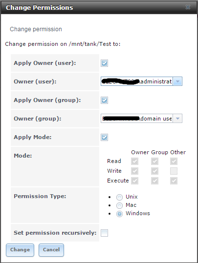

Keep in mind that it is possible to have 775 permissions (which is what you have in the very first screenshot) and still not have true "full permissions" because Unix permissions don't translated directly to NFSv4 (Windows ACL) permissions..
So I think you need to look into permissions and how those are setup for your system (read up on getfacl and setfacl). But, I also don't get why mountd is saying what it is saying. mountd should not be saying anything when accessing cifs shares.

I checked the permissions and Everyone is not set the same as the others (as it should be). I did change that however (attached) and am still unable to access the folder. I get the permissions don't translate directly but it just seems like it's not wanting allow me access regardless.

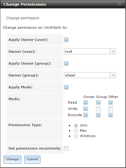

What's the ACLs on /mnt/tank?
Elegant
Aug 27, 2015
67
See attached. I messed with them once or twice (matched them to the Test permissions then reverted) but yielded no results. Maybe I am doing it wrong?

cyberjock
Inactive Account
Mar 25, 2012
19,525
Permissions look okay. Not sure why you can't authenticate. You providing the domain name with the username?
