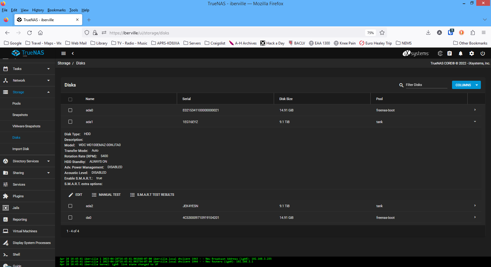

OK, maybe this is a dumb question, but - where is the 'replace' button in the GUI? I'm running TrueNAS-12.0-U8.1 and decided it is time to update everything. I intend to reuse my old IX Systems FreeNAS Mini [having purchased not 1, but 2 new TrueNAS mini+ systems in the last month that had hardware issues and had to be returned...]. While my primary inclination is to rebuild everything from scratch and hopefully do better than i did before in configurations, it will be nice to see what comprises the option to replace a drive from the GUI.

Al Fuller
Aug 11, 2015
16
Thanks for pointing me back to the docs. However, what I am seeing on my system is inconsistent with what I see in the docs. See attached screenshot, where there is no ". . ." menu, and no replace button on my system.
Did I take the wrong path through the GUI, or something else?
