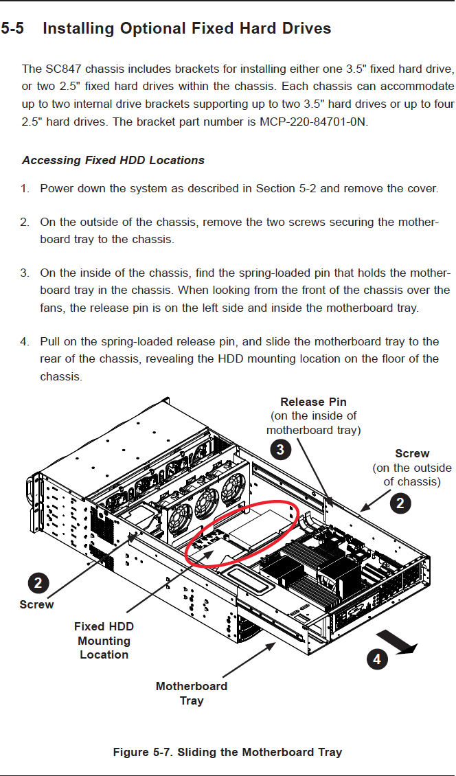

SumitB
Aug 26, 2014
15
The 847 is a 36-bay chassis... 24 in front, 12 in back. There isn't much room left after motherboard, power supplies, and PCIe. All of the drives, including boot and SLOG, are in drive trays.
As per the manual of the 847 from Supermicro's site, it says on page 5-6;
"The SC847 chassis includes brackets for installing either one 3.5" fixed hard drive, or two 2.5" fixed hard drives within the chassis. Each chassis can accommodate up to two internal drive brackets supporting up to two 3.5" hard drives or up to four 2.5" hard drives. The bracket part number is MCP-220-84701-0N."
So you would be better off going with the MCP-220-84701-oN bracket and freeing 4 of your hot swap drive bays. This is what I am also planning to do. I will get 2 x 120GB and 2 x 250GB SSDs for my boot drive and Jails/System Dataset.
You could use the internal drive mounts for a SLOG or some SSD for your boot drives or for you Jails. I will end up using mine for 2x SSD for my jails eventually.
This is exactly how I am planning the install.
Apparently these go under the motherboard tray. At this point, I have drive bays to spare... down the road, if I run out, good to know this is an option.
SumitB
Aug 26, 2014
15
Yes, they indeed go under the motherboard tray.
