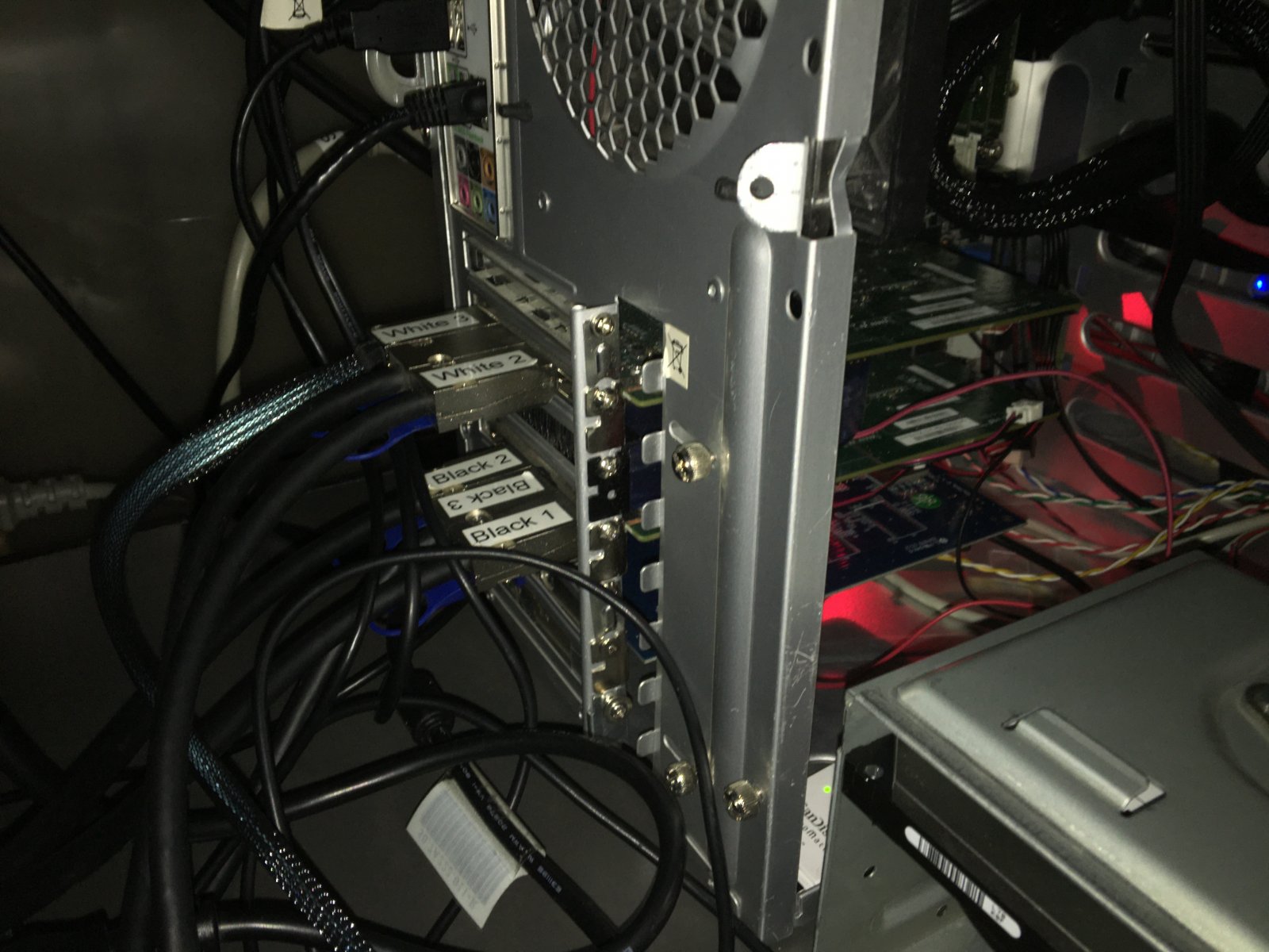

I first did my build on the cheap but now want to upgrade cases to get rid of temperature warnings. I am running 11 x 4 TB and 11x 8TB SATA drives and two small SSD SATA boot drives. I have tried to do my research but am getting stuck on the tech. I found a couple server cases on ebay but I didn't see enough SAS cable plugs in the back (one plug for each 4 drives) suggesting an expander which I can't use for SATA drives. Hardware guide says I need a plain SAS backplane.
I found this item which I THINK may handle 12 of my drives and my motherboard:
I would appreciate explanations, recommendations and links.
Thanks in advance.

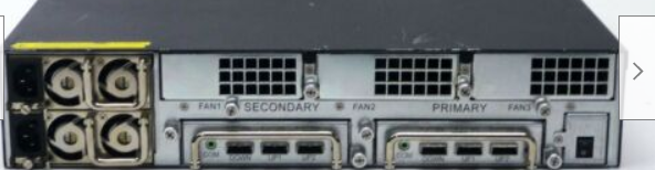

Hello and thank you...
It seems I have been working under a misperception. I thought that expanders were not recommended for use with SATA drives. As such I currently use 4 in 1 8087/8088 SATA breakout cables.
If I am reading your post correctly I could I use this 24 bay case?:
The rear of the case has "primary" and "secondary" input sections. Each has two inputs and one output to cascade to additional chassis'.
If so could I use my current HBA?
How many cables would I attach? 1, 2, 3, 4?
reference:
/e
reference:
/e
Having no experience with that product but assuming it to be a simple JBOD with an SAS expander.... DO YOUR HOMEWORK(!!!)...
If it's an older SAS1 (3Gbps) expander based array, it may be limited to drives of no more than 2.2TB capacity.
A SATA disk only has a single channel. A SAS disk typically has a primary and secondary channel (again see SAS Primer if q's). To use a JBOD with SATA disks you will need to use the primary channel. You can hook up the secondary but it won't be talking to any SATA drives.
The two inputs are intended to attach to different servers so that you can have a failover arrangement, but you may also connect both to the same server to theoretically double the speed of the connection between the HBA and the expander. This probably won't actually do much for you, and I've seen cases where that doesn't work, so my suggestion is "one cable".
"Output" and "input" on an expander are generally no such thing; expander ports are bidirectional unless specifically configured in a manner that I rarely see. They put the labels on the chassis to reduce confusion. It is SUPER IMPORTANT not to create a loop. Almost any tree topology is acceptable. This means you could have a stack of three or four of these all in a daisy chain and feed the whole thing with a single SFF8088 from your HBA.
If you have an internal HBA you can buy an AT slot paddleboard to bring the SFF8087 out to an SFF8088. See eBay for example.
You helped me dodge a bullet!:
" 3Gb dual ported SAS; 1.5Gb/3Gb single ported SATA "
