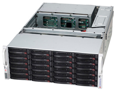

I came across a SC847J 45 disk rackmount chassis, which I'd like to use.
Like this?
The eight "ports" on a SAS controller are more appropriately called "communication lanes" and can be directly attached to individual drives or to a SAS expander. The backplanes inside that rack chassis have integrated SAS expander chips that spread the communication between the connected drives in a similar way to what a network switch moves data packets between the ports. Each drive can communicate with the controller and the controller can talk to the drives.

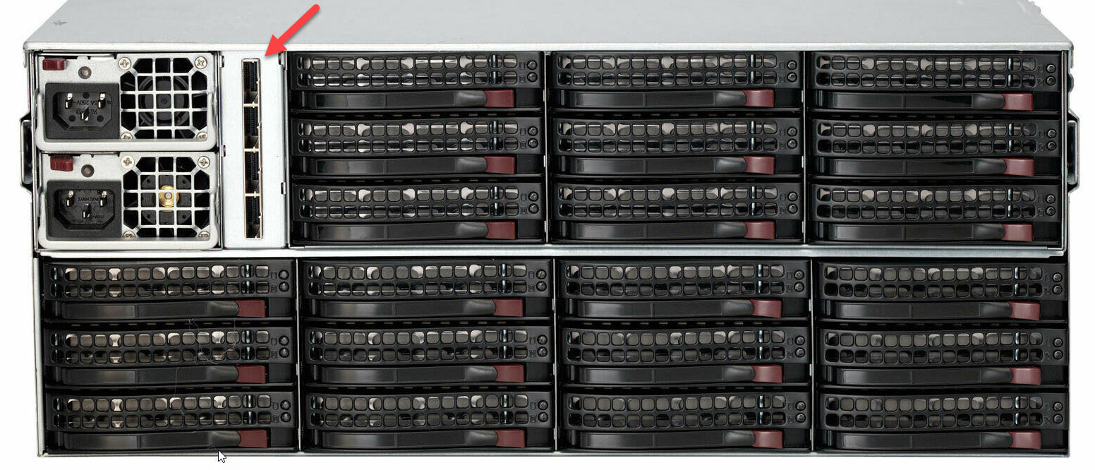

On the back of that unit are these external SAS connectors:

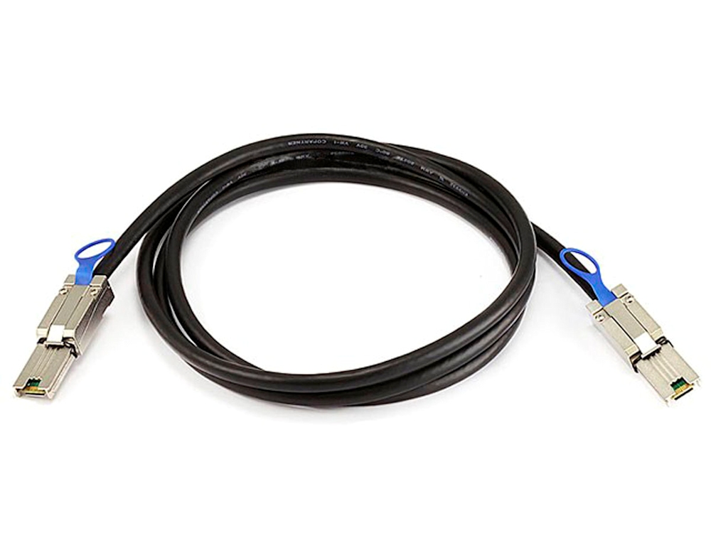

You connect to those with a cable like this:
Many vendors have these cables in different lengths, just make sure the model of the connector.

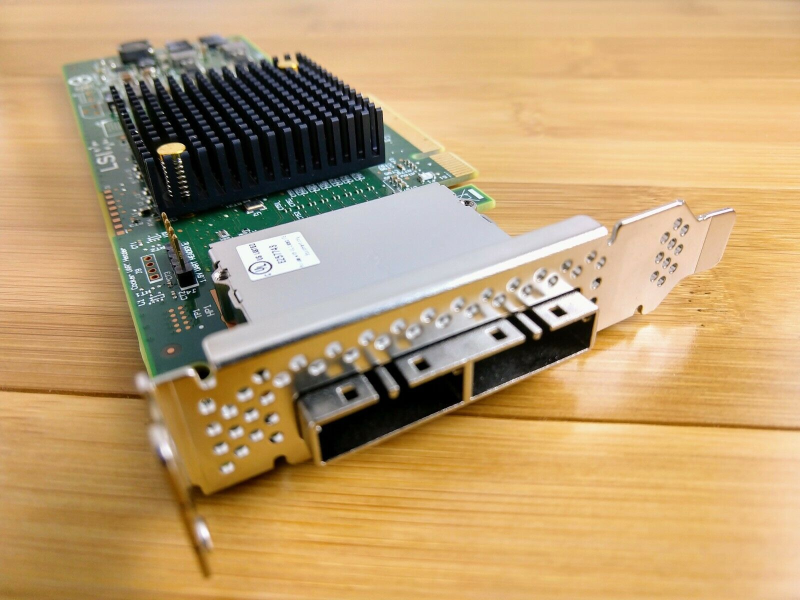

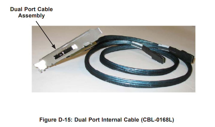

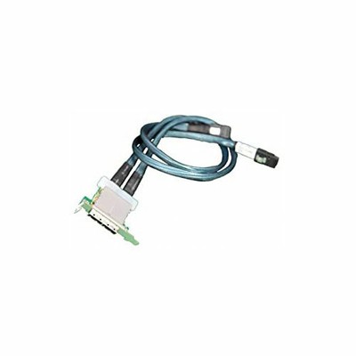

This cable set will allow you to turn the internal SAS controller into an external one:
Alternatively, you can purchase a SAS controller that was made to be external to begin with:
Or this one:
