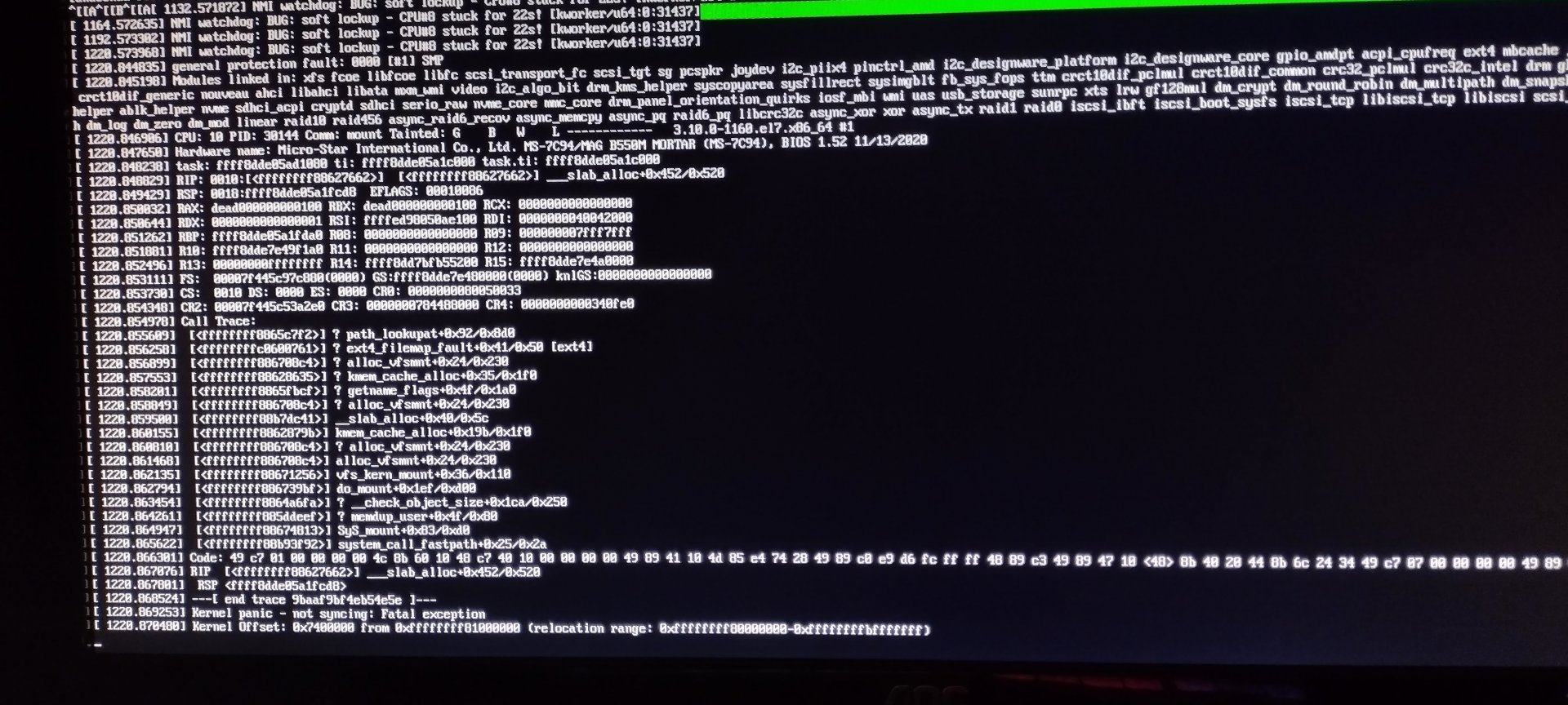

So I've made my own NAS that has a bunch of other functions on CentOS and it's becoming less stable, locks up sometimes with a kernel panic, tried all of the available kernels and none work well, now the bootloader is corrupted. I'm thinking of switching to TrueNAS but I'm used to Linux, not Unix.
That it is a very strong pointer to a hardware issue. I don't know how many systems (although mostly VMs on ESXi) with CentOS 7 (and also earlier versions) I have set up over the last 12+ years. Not once have I seen such a behavior without hardware being the root cause.

Any idea what? They're all fairly new parts from a former windows machine
Your best bet will be to replace various parts one by one. But of course that is only an option if you have those parts available.
The screenshot seem to imply that the problem surfaces at the CPU level. But, if I read this correctly, that would only be a symptom and by no means has to be the root cause as well. In general, the culprits I have seen mostly are RAM modules (including bad seating!), the PSU, and adapter cards with contact problems. But of course the CPU or motherboard could have gone bad as well.
