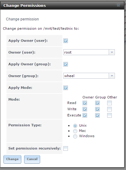

If I create a dataset as Unix share I can manage the permissions as expected. I can do this:

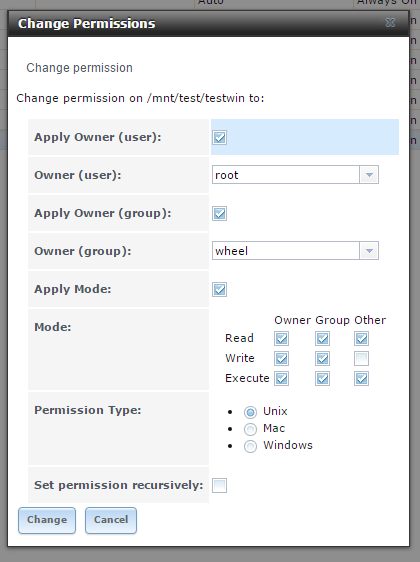

However, it allows me to change it back to Unix share.
When I do this the permissions appear to work as-expected but the "Other" is always stuck on Read and Execute - no matter how much you change it. Reload and it's back to:
As such, setting something to -r for other has no effect even though it looks like it did.
This is quite repeatable.

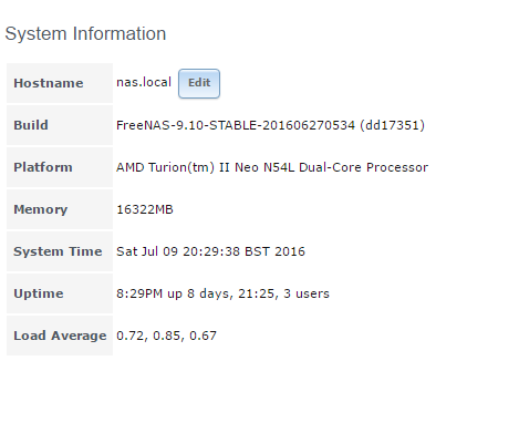

My system - latest updates on 9.10
