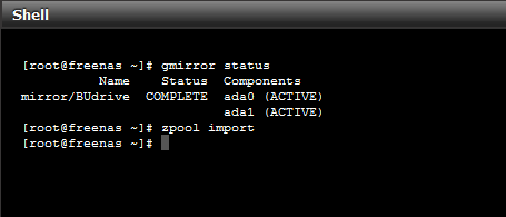

The lack of a config file shouldn't make a difference in an import.
What is the output of "gmirror status" (within code tags)?
cyberjock
Inactive Account
Mar 25, 2012
19,525
and the output of zpool import. You should use pastebin for the output of zpool import or it will be useless to me.
Feb 17, 2014
4
Sorry for the late post. It's been a crazy week. I ran the 2 commands in the shell & posted the output to pastebin. Here's the link: http://pastebin.ca/2645479 freenas001.PNG

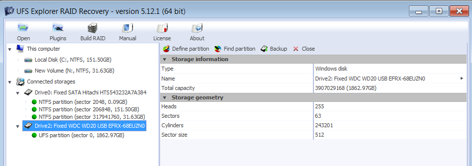

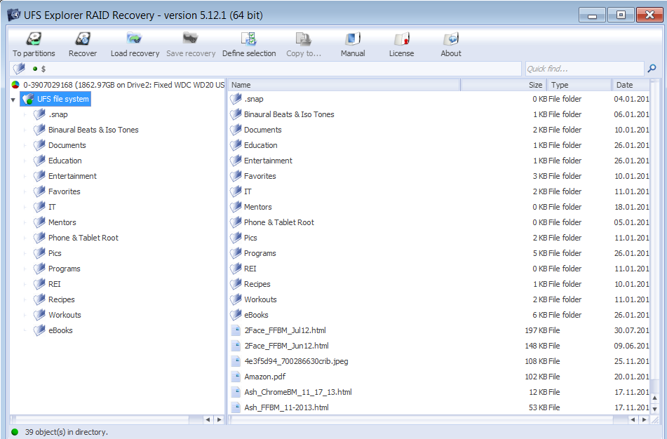

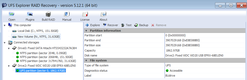

Recent development to report: Over the weekend I've scoured the forums trying to find something that would give me resolution to this burning issue, so I can get closure...one way or another. Well to my surprise, I stumbled upon a post that mentioned some software I'd never heard before: UFS Explorer.
Hoping against hope, I went to the website (www.ufsexplorer.com) & downloaded the UFS Explorer RAID Recovery trial. After installing it on my Windows 7 machine, hooking one of my 2 mirrored (2TB) drives into an external USB enclosure I am happy to report my suspicions: all the data is still there!!! :D:D:D:D:D (I'll upload some screenshots at the end of this post).
Now the question is this: If UFS Explorer can see the unharmed data, why in the Johnny BLAZES isn't FreeNas letting me import my volume? I am willing to give up on the idea of being able to import the volume, as long as I can mount the drive & pull what I'm missing from my backup . Then I could finally start from scratch with 1 MAJOR lessoned learned: BACKUP your config file REGULARLY!!! On top of that, after all the reading from these last couple of weeks, I'm curious to set everything up right & give ZFS a go.
Can anyone help with my question (it's the one in bold;))?
