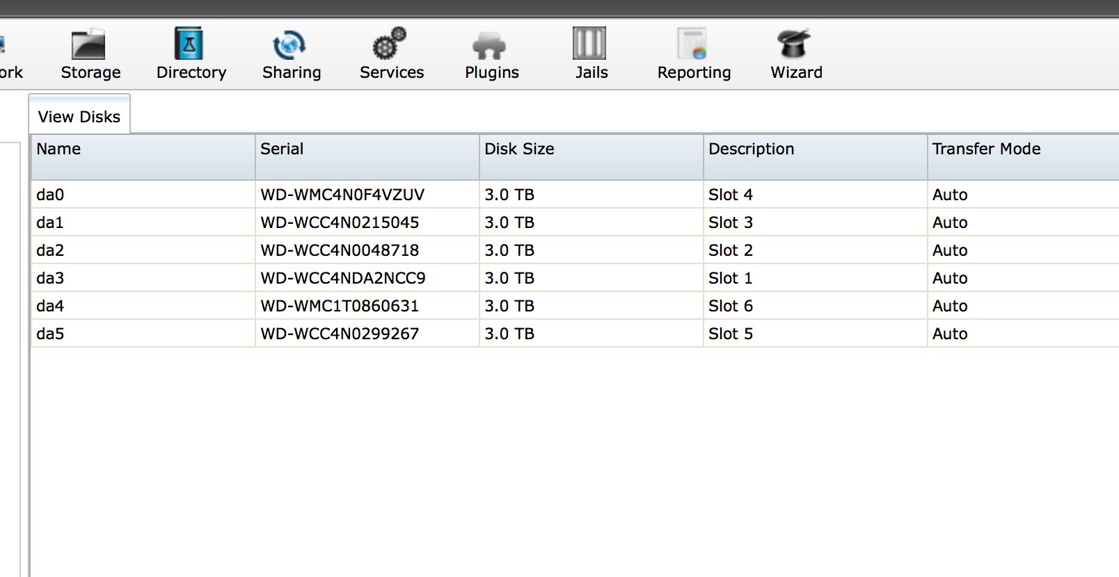

If it helps somebody else, I've put the physical location of the drive in the enclosure in the description field of each drive in Storage -> View Disks. This persists correctly across reboots even if the OS changes the name of the drive.

Don't trust these fields, they are as good as the device label (/dev/adaX, /dev/daX, ...), only the GPTID and the S/N are ok to identify a drive in the long run ;)
How so? Are they not stored on the disk? Do they spontaneously disappear?
One issue is when the disk does die, you don't see the field...

No, they're stored in the database (you now the config file you can save? it's actually a dump of a SQLite DB) and they're mapped to the device label (hence why they aren't better).
But yeah, I recommend to map your drive info before you have a problem (a bit like you should backup your config before anything happens) so you don't have to go on a treasure hunt the day a drive die... I actually made a script for that, look at the useful scripts link in my signature if you're interested ;)
That's not exactly true.
[root@freenas] /data# sqlite3 freenas-v1.db
SQLite version 3.11.1 2016-03-03 16:17:53
Enter ".help" for usage hints.
sqlite> .schema storage_disk
CREATE TABLE "storage_disk" ("disk_acousticlevel" varchar(120) NOT NULL, "disk_hddstandby" varchar(120) NOT NULL, "disk_size" varchar(20) NOT NULL, "disk_serial" varchar(30) NOT NULL, "disk_multipath_name" varchar(30) NOT NULL, "disk_identifier" varchar(42) NOT NULL , "disk_togglesmart" bool NOT NULL, "disk_number" integer NOT NULL, "disk_advpowermgmt" varchar(120) NOT NULL, "disk_transfermode" varchar(120) NOT NULL, "disk_multipath_member" varchar(30) NOT NULL, "disk_description" varchar(120) NOT NULL, "disk_subsystem" varchar(10) NOT NULL, "disk_smartoptions" varchar(120) NOT NULL, "disk_enabled" bool NOT NULL, "disk_name" varchar(120) NOT NULL);
CREATE UNIQUE INDEX "storage_disk_disk_identifier" ON "storage_disk"("disk_identifier");
sqlite> select * from storage_disk;
Disabled|Always On|3000592982016|     WD-WCC4N0048718||{serial}     WD-WCC4N0048718|1|2|Disabled|Auto||Slot 2|da||1|da2
Disabled|Always On|3000592982016|     WD-WMC4N0F4VZUV||{serial}     WD-WMC4N0F4VZUV|1|0|Disabled|Auto||Slot 4|da||1|da0
Disabled|Always On|3000592982016|     WD-WCC4NDA2NCC9||{serial}     WD-WCC4NDA2NCC9|1|3|Disabled|Auto||Slot 1|da||1|da3
Disabled|Always On|3000592982016|     WD-WCC4N0299267||{serial}     WD-WCC4N0299267|1|5|Disabled|Auto||Slot 5|da||1|da5
Disabled|Always On|3000592982016|     WD-WMC1T0860631||{serial}     WD-WMC1T0860631|1|4|Disabled|Auto||Slot 6|da||1|da4
Disabled|Always On|3000592982016|     WD-WCC4N0215045||{serial}WD-WCC4N0215045|1|1|Disabled|Auto||Slot 3|da||1|da1
sqlite>
Disk identifier is built on the serial, and the table is indexed on that.

Maybe but some time ago a member used the desc field in the disks tab and they where following the device label changes, no the S/N.
So you do what you want but my advice is to not use them to identify a disk across reboots ;)
