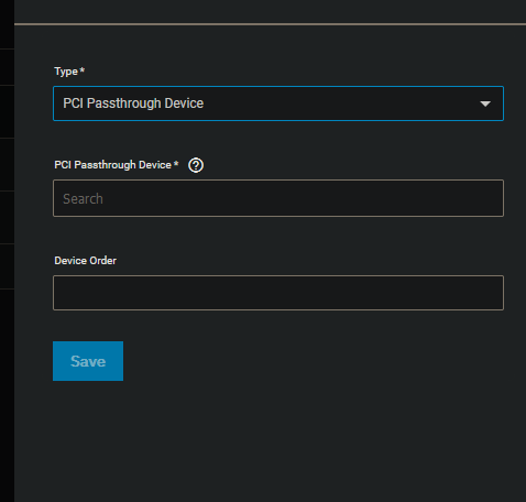

On the long-ass list you'll find the PCIE Device # & you'd punch it in here when you're setting up/setup the VM under the 'Devices' section:
