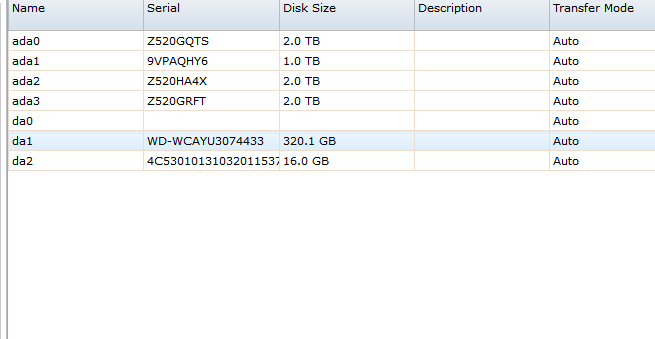

I can see the drives. even in gui. the thing is that it apears as if i have fresh install of freenas. because i deleted the corupt boot option after bad update

rvassar
May 2, 2018
972
Any chance you have a saved copy of your config? You should be able to restore it and recover the old configuration. If not, you can still import the pools using "zpool import".
