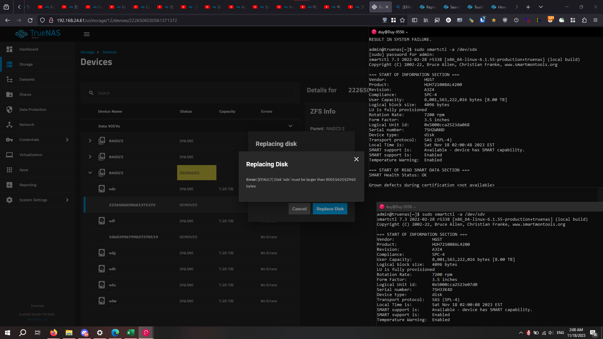

I have a VDev that I'm trying to expand to 8TB drives. It used to be 4TB drives. I replaced 6 of them a month ago and now I'm trying to replace the last 2, but the WebUI won't let me and gives an error that the drive is too small.
I don't see anything out of the ordinary with the drives, any reason why it won't let me? It happens with both of the new drives.

The new 8TB drives are all the same make and model with all the drives in that vdev? We may need a bug ticket with debug file to look closer.

In my case, the drives are a mix of models. And 1 of the drives is SATA while the rest are SAS.
I got it to work by reinserting 1 of the 2 4TB drives I was trying to replace. Doing a replace on the missing drive and then removing the 4TB and replacing again.

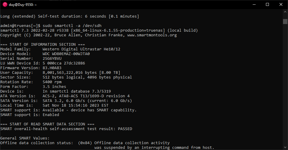

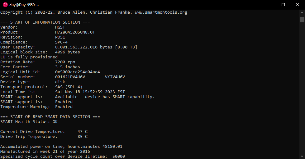

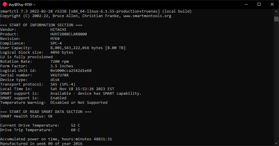

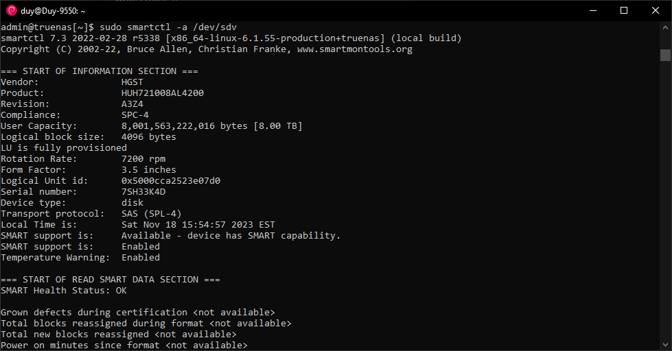

All of my drives are WD, HGST, Hitachi variants.
HUH72808CLAR8000
H7280A520SUN8.0T
WDC WD80EMAZ-00WJTA0
HUH721008AL4200
