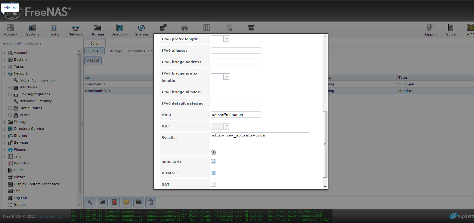

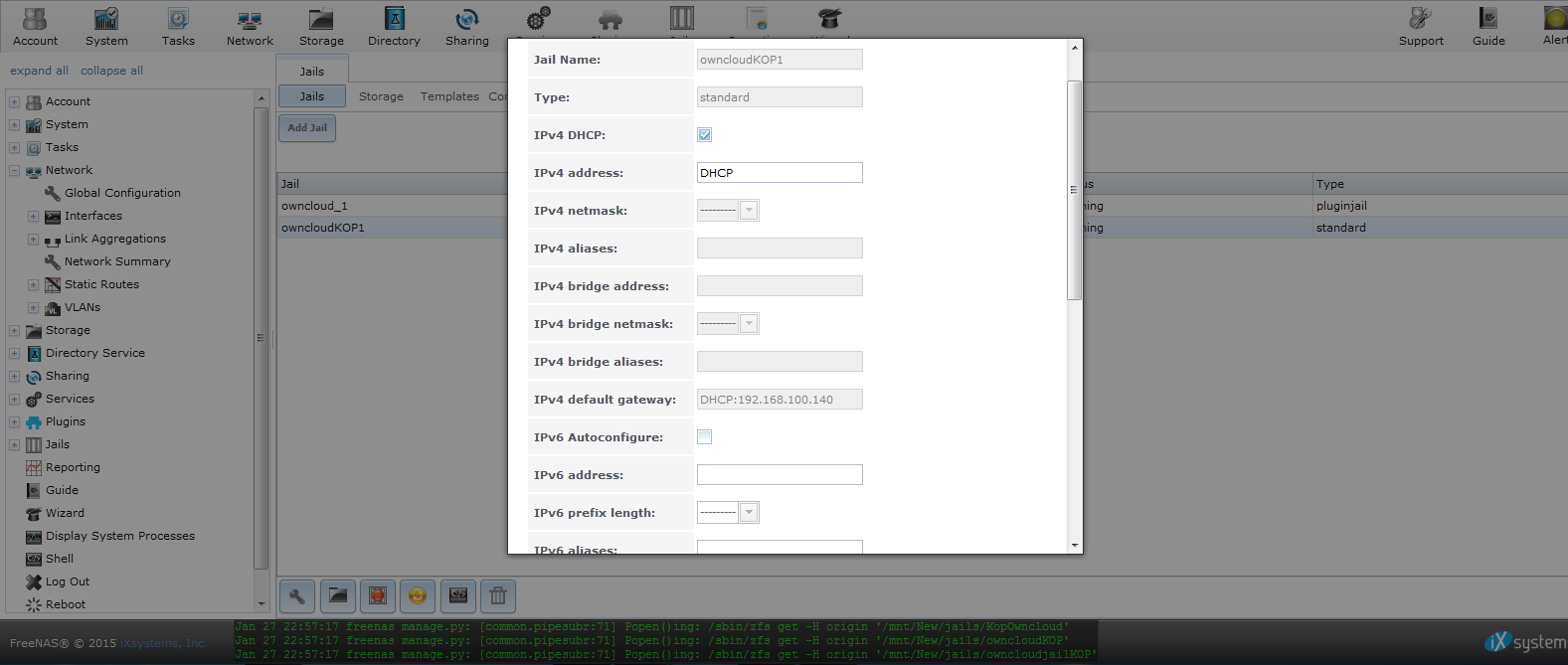

Here are the Configurations of the Jails. If you would need something more tell me i can send it too. Im just not sure where can be the problem.

I know it's set to DHCP, but is the gateway correct? I'm making a lot of assumptions, but the 192.168.100.140 address is a strange gateway IP unless your manually configured your router to be at that address. Out of curiosity what happens if you create a new jail? I'm curious if you can reach a newly created jail.

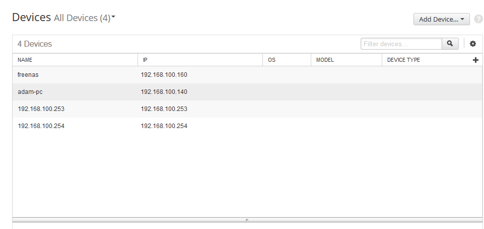

I Tried everything. I m running it on Virtual Box btw. Not sure witch IP should i use as gateway. :/ Maybe that's the problem but non of them works
Your nic in vbox should be bridged to your computer's nic and your gateway for Plex and the jails would be the same as your PCs gateway aka your router internal IP address
