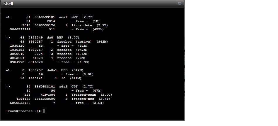

When I look at the 2nd drive through the "Import Volume" function it shows it as two for some reason, ada1p1 3.0TB and ada1p2 2.1TB. There any reason why it would show up as 2 drives instead of 1?
Those aren't 2 drives, they are 2 partitions on the same drive. FreeNAS creates a swap partition before the data partition.
It sounds like you originally created 2 one disk vdevs striped in the same pool and then removed half of your stripe. "Import Volume" wouldn't be the correct way to add that disk back to the pool, I think you probably needed to reattach it / online it to make it part of the pool again, but I'm also wondering if you could have wiped the wrong disk.

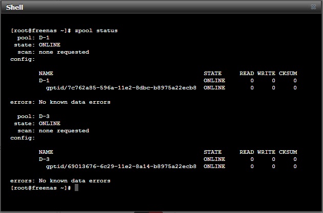

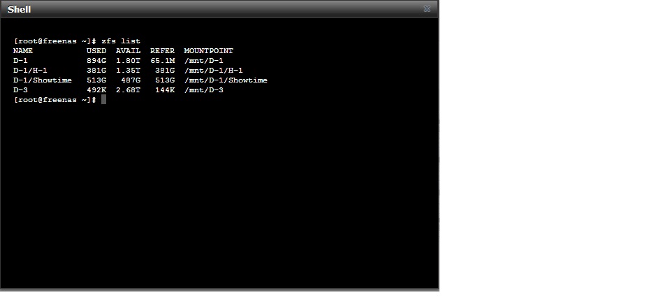

Just for grins, you could post the output of these commands:
zfs list
gpart show
v33
Jan 31, 2013
7

So since ada1p1 and ada1p2 are two partitions of the same drive, is that why I am unable to import it? Is there a way to merge them so that I can bring everything back to a readable state?
Actually, ada1 appears to have a single 2.7TB linux partition on it. D-1 appears to be a single 2TB disk pool and D-3 a single 3TB disk pool. You couldn't be bothered use SSH and the gpart show is cut off, but I guess ada0 contains D-1 and ada3 is D-3.
glabel status
Would confirm that.
Exactly what are you trying to do with ada1 and the linux partition?

You are exactly correct. The missing 'zpool' is actually a linux-data partition. I just did a Teamviewer session with the OP. It won't "auto-import" and I wasn't sure of how to mount it properly since its his data. He's going to see if it auto-mounts with an Ubuntu LiveCD to verify the file system format. It's definitely not ZFS so it should be identified by Ubuntu.
